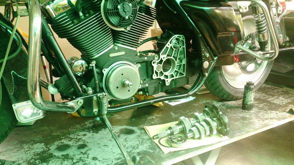

    Time to get this done. I've never used Ultima gear in any of my bikes before; but, for literally 1/4 the price of Baker or SE I'm compelled to give it a shot. So far (IMHO) I've noticed some inferiority in the shift drum and shims & 1 bearing missing from the kit. Not even close to a show stopper though.
    Time to get the main bearing out of the freezer.

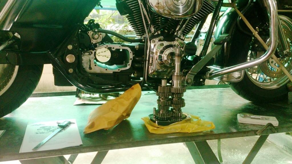

    Apologize for the late results on this install. Anyways, I had to do some extra grinding in the case for the indent spring. Also had to use a lot of my own bolts. Neutral's harder to find. 4rth has a little whine to it with an additional neutral light. 6th has a nasty whine (these whines are probably tight gear meshing IMHO). They may wear and fade with time or something catastrophic may happen. I'll have my 5 rebuilt & standing by either way.
    On another note for any of you Harley guys, I'm going to post a good engine oil alternative with a link to the spec sheet under the "what oil are you using thread".
    Ride safe!
