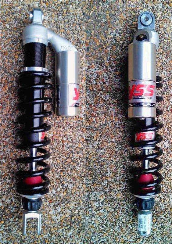

This is the spring John sent me:
The original D-Tracker spring below, off my bike!
This spring has a very nice progressive feel & still absorbs the little bumps very well but comes into it's own when I start throwing the bike into undulating fast twisty corners. Feels fantastic & has great predictable handling. :thumbup:
Can actually have a normal sized pillion passenger on the back without having the bike sitting to low or bottoming out on bumpy corners anymore. :thumbup:
Kurb-hopping & jumping speed humps at 70+km/h is effortless. :thumbup:
Slamming on the brakes at 140km/h is now safe, predictable & easy......does not dive into the ground!! :happy2:
