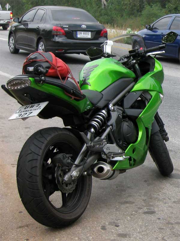

    When I ditched the stock can on my ER6n in favor of a TWO BROS can I also experienced a lot of backfiring.
    The three things I did that greatly reduced the backfiring were:
    1) Installed a Juice Box Fuel Injection Controller that comes programmed for the bike and exhaust.
    2) Plugged the PAIR valve to reduce/eliminate air in the exhaust.
    3) Installed an ignition booster which increased horsepower and torque and probably created more complete combustion leaving less unburned fuel to cause backfiring in the exhaust.
    (BTW, I have to agree with those of you who say the TWO BROS is a bit too loud- though at times it was pretty fun being a hooligan on that bike :mrgreen:) I have the Arrow on my Ninja 650R and find it a bit more agreeable, though still quite loud with baffle removed.
