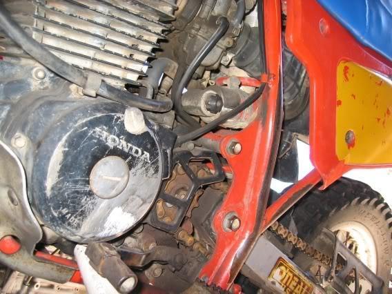

    before
    [​IMG]

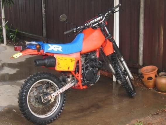

    After,
    [​IMG]

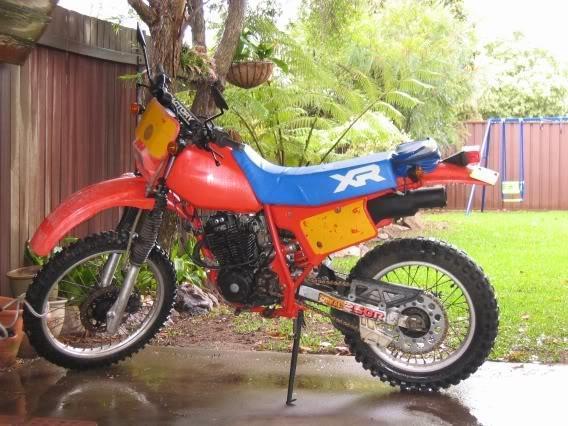

    [​IMG]

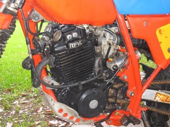

    [​IMG]
