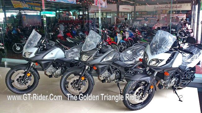

    But have you considered the Suzuki V-Strom 650,
    [​IMG]
    http://www.gt-rider.com/thailand-motorcycle-forum/showthread.php/38875-Suzuki-650-V-Strom-sold-here-soon
    that's what I would be going for over a Versys now.
    19 inch front wheel
    V-Twin motor - torque
    + better all round spec over the Versys.
  12. NickyBKK
    NickyBKK Ol'Timer
    Saw that bike in person last week and it looks very well built. It's a large bike. Feels very spacious. Price was 350k I believe. I would take the vstrom very serious if was in the market for this kind of bike. Love the 19 inch front wheel.
