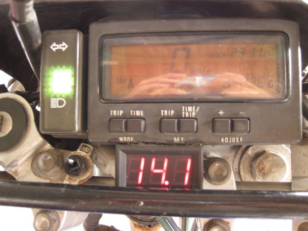

So, a few months ago, I happened on the thread below for installing an inexpensive LCD voltmeter,
and ordered and received 2-voltmeters one for each of my bikes. The voltmeters are a mere 70-Bt each
and postage is free! They are made in China, but they are _not_ waterproof.
http://www.f650.co.uk/forums/showthread.php?12603-useful-voltmeter-installation
I applied a liberal coating of clear silicone on the circuit board and side of the unit making it waterproof.
Silicone, as well as superglue adhesives are both non-conductive.
The silicone adhesive failed to adequately glue the LCD on the bike's display, so I used contact cement.
I connected the LCD display to a wire that is only hot when the key is turned on; it can be grounded
any where that is convenient. So, now with fair warning, maybe there's no more unplanned dirt naps!
Below is a pix of the voltmeter on my Suzuki:
