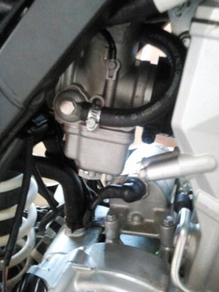

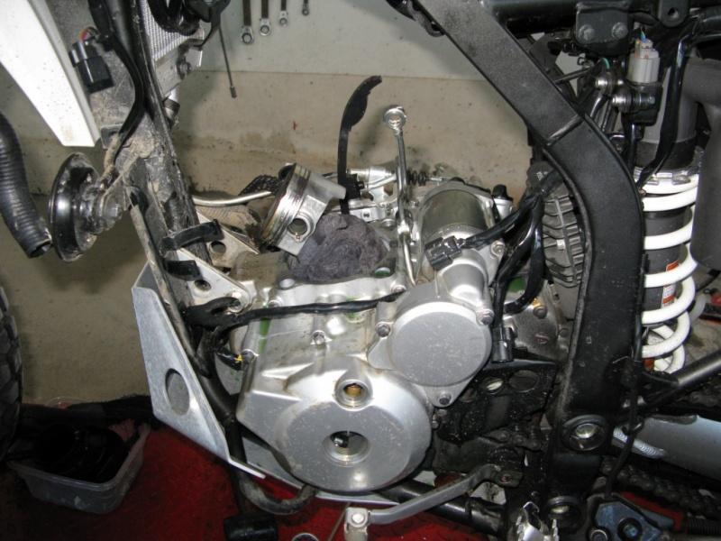

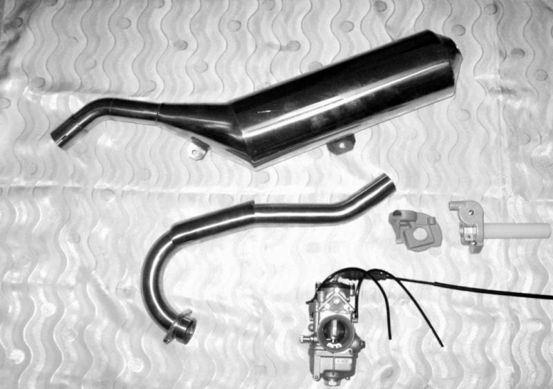

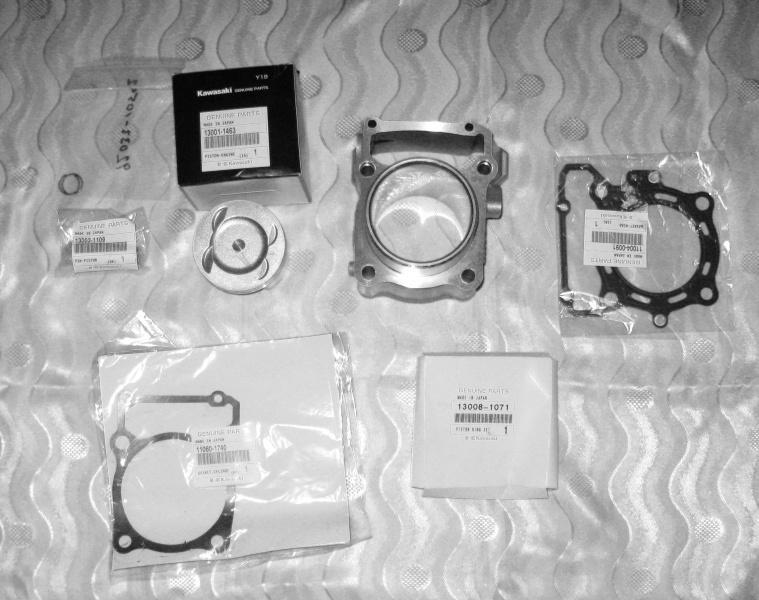

    Anyway getting back to the conversion kit, I bought one.

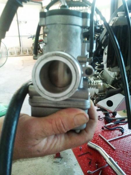

    Complete with the 300cc Kawasaki Factory big bore kit, 34mm Delorto competition carb with a quick action throttle.
    I also purchased a race tuned 304 grade stainless steel engine pipe and exhaust used by the Kawasaki Motocross team.
    I used my good friend Liam, an ex racer and motorcycle mechanic from Ireland and now residing in San Sai, Chiang Mai to do the conversion.
    He specialises in suspension setups, carby balancing, motor strip downs and general maintenance
    You can contact him on 0822711923
    Email: [email protected]
    GPS Coordinates: N18deg 50.419 E099deg02.897

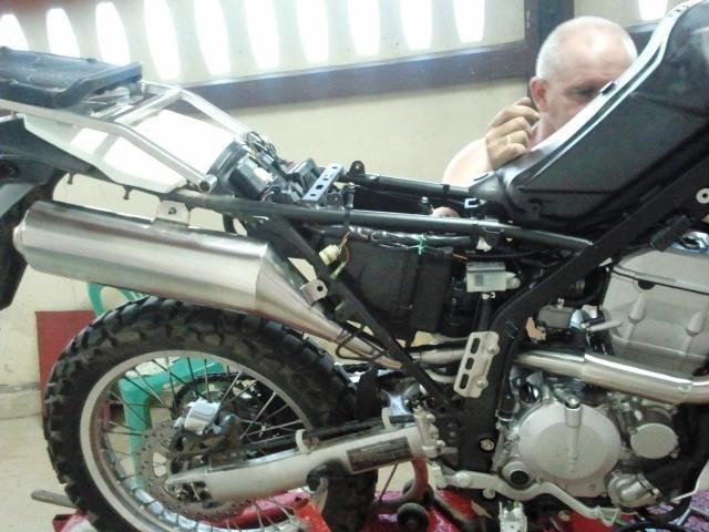

    After a week of trial, error and frustration we got the little beast to really fly, (a few wee secrets were learned along the way, which Liam will keep to himself!)
    Remember we are converting a fuel injected bike back to a carby, then upgrading to a 300cc big bore kit. It is also a brand new bike with a 1000km in the speedo (I guess I now have voided my warrantee!)
    Stage 1 so far is a success

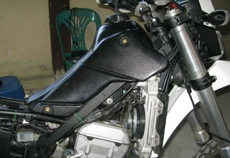

    Well Liam and I have completed stage 2.

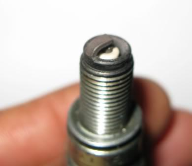

    It took over a month to fine tune the carb, different jetting and needle settings were tried around the mountains, a lot of popping high up because of the altitude.
    We finally got a good compromise with the settings.
    [​IMG]
    Good nice colour

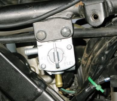

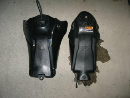

    We then fitted the IMS plastic tank from the US, complete with the US carby versions fuel **** system
    [​IMG]
    [​IMG]
    [​IMG]

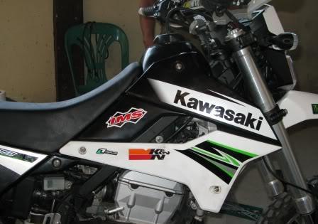

    This is the IMS tank fitted
    [​IMG]
    The finished look
    I now have a KLX that can cruise on 110km/hr. with a range of 200+km before reserve.
    I am sitting on the optimum rev range for power and torque: 7000/8000 rpm with enough power to pass traffic.

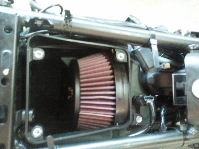

    I have also saved over 5kg of weight by shedding the emission control and the the fuel injection mechanics.
    Liam didn't have to alter any of the wiring loom, just blanked off connections and looped around the CPU.
    If in the future I wish to go back to the fuel injection it will only take about 8 hrs work.
    Love my my transformed KLX.

    I Love that Tank! I saw it in the flesh the other day and You could hardly notice the Change! Very well done without going overboard like those Huge Exon Valdez Tanks that Look so Grotesque!!! Can't Wait till they make one for the Fuel Injected Bikes!
