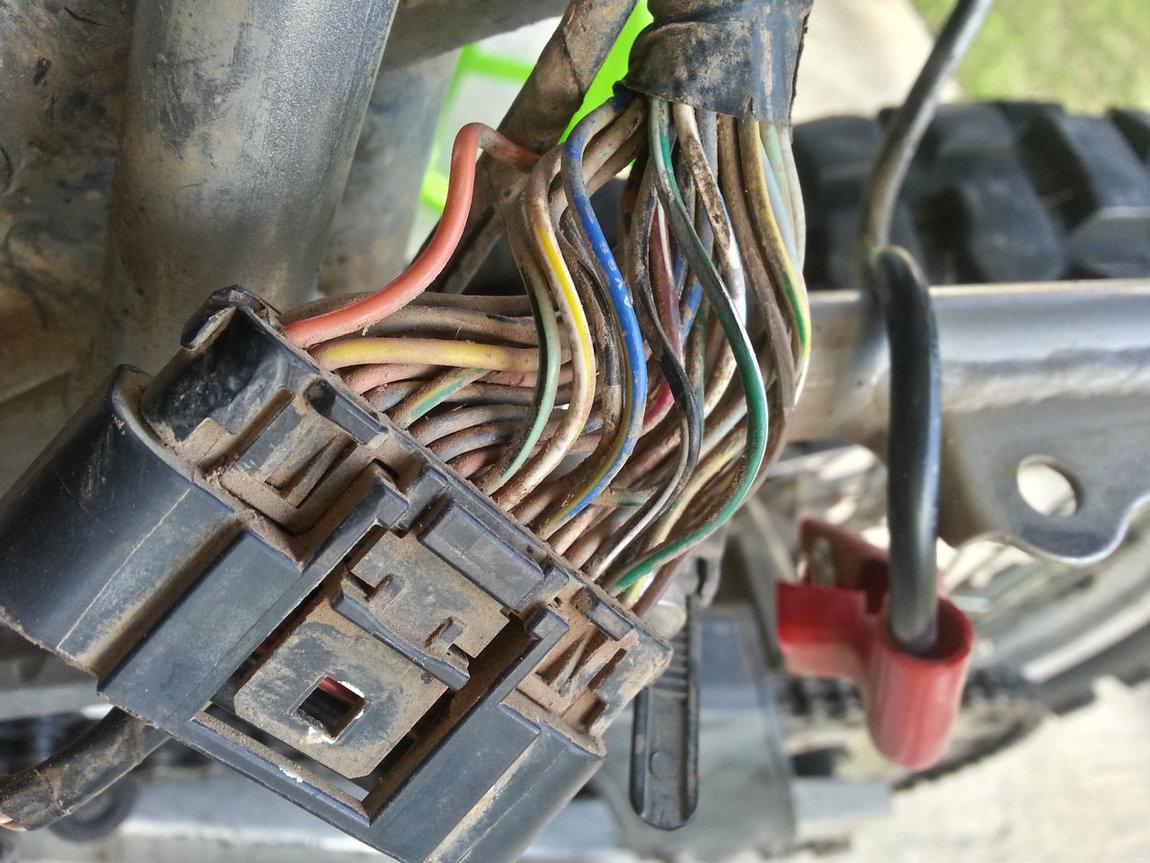

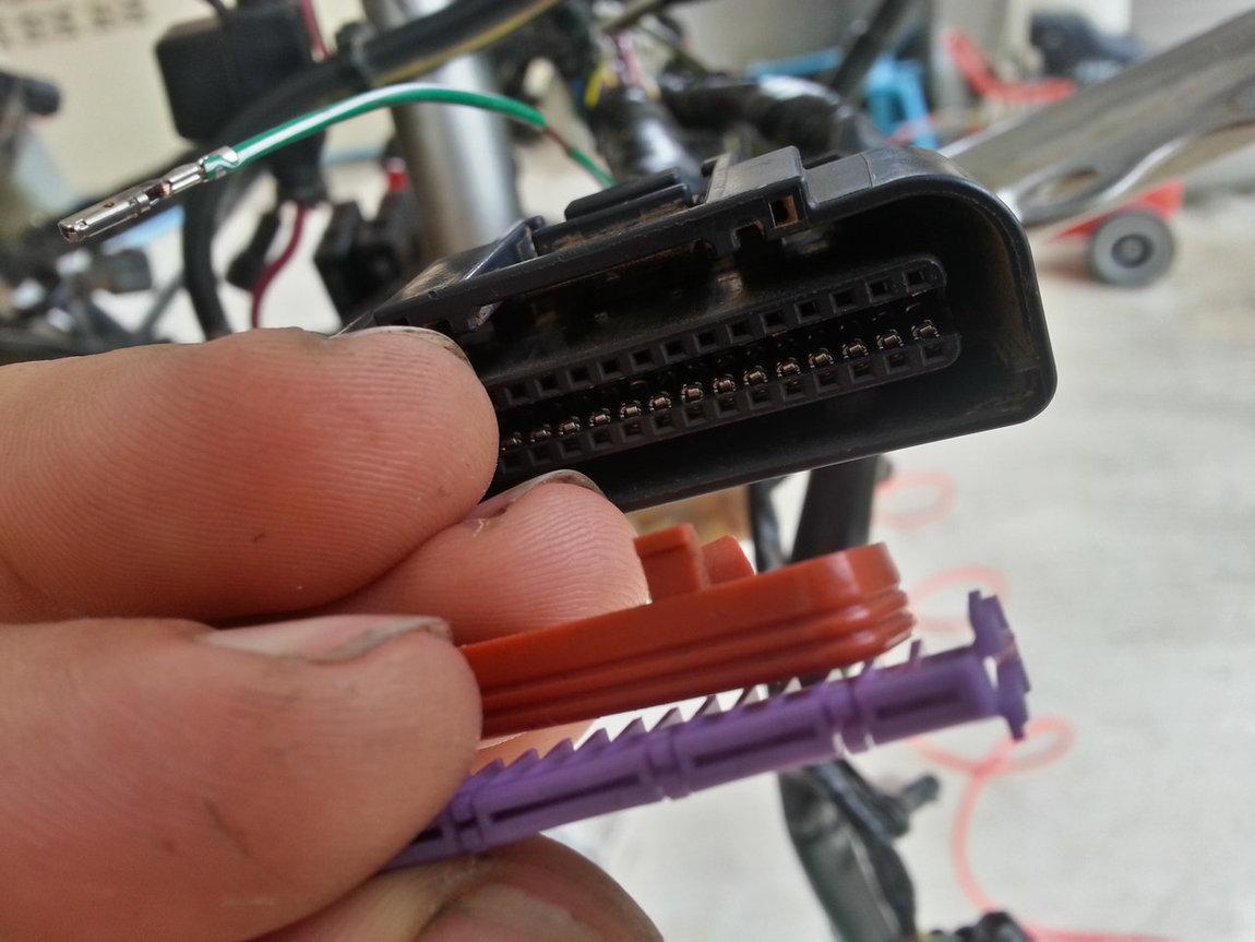

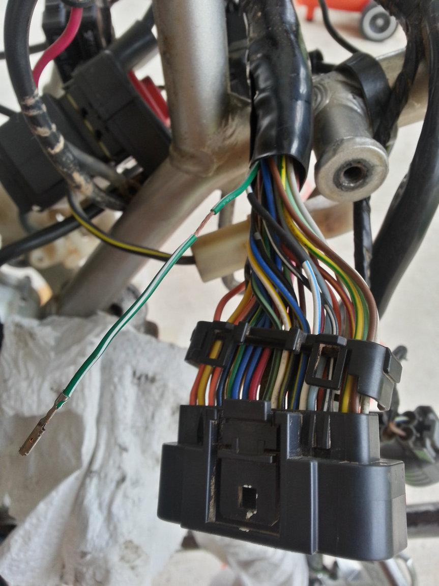

    1) I found some info that the ECU connector lead is prone to chafing on the 2009 model bikes, a forum posting even mention there was a recall about that, and the newer part number for the wiring harness has that problem fixed by wrapping the ECU connector lead in electrical tape almost until the connector itself. On mine, a couple of wires had their insulation chafed through to the bare copper, some of the copper strands broken and the rest had minor corrosion. One of the wires was from the crankshaft position sensor - if the ECU doesn't get proper signal from this sensor, I doubt the engine can work at all. I had the FI indicator light showing "error 21" which is the crankshaft position sensor a couple of times, but not always, when the bike failed to start. Couple more wires had insulation partially chafed through, but copper still not visible. Fixed by soldering and heat-shrink tubing (disassembled the ECU connector and release the affected wires' terminals to get access). I verified each and every circuit continuity on the bike with a multimeter. Took a while with the wiring diagram, but felt pretty satisfying.
    I also found several wires chafed on the leads coming to the fuse holders and started circuit relay. Don't know what exactly did that damage because these leads stay between the airbox and the black plastic fender part, no sharp edges there, just rubbing against the plastic for many thousands of kilometers I guess. Again, insulation was worn through and half of the copper strands were broken, no corrosion though. Fixed by soldering and heat-shrink tubing.
    After all the wiring was fixed, I cut some high-temp PVC sheathing lengthwise and cover the leads with that, then taped over with nice 3M electrical tape. The ECU connector lead I wrapped with a more flexible but really thick and tough 3M rubber splicing tape, then overwrapped with the electrical tape.
    Pics of somewhat damaged ECU connector wiring:

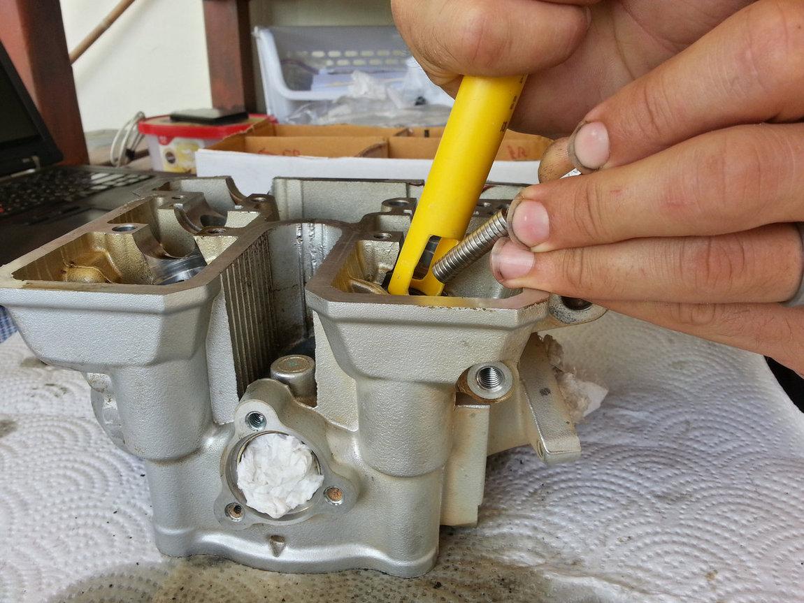

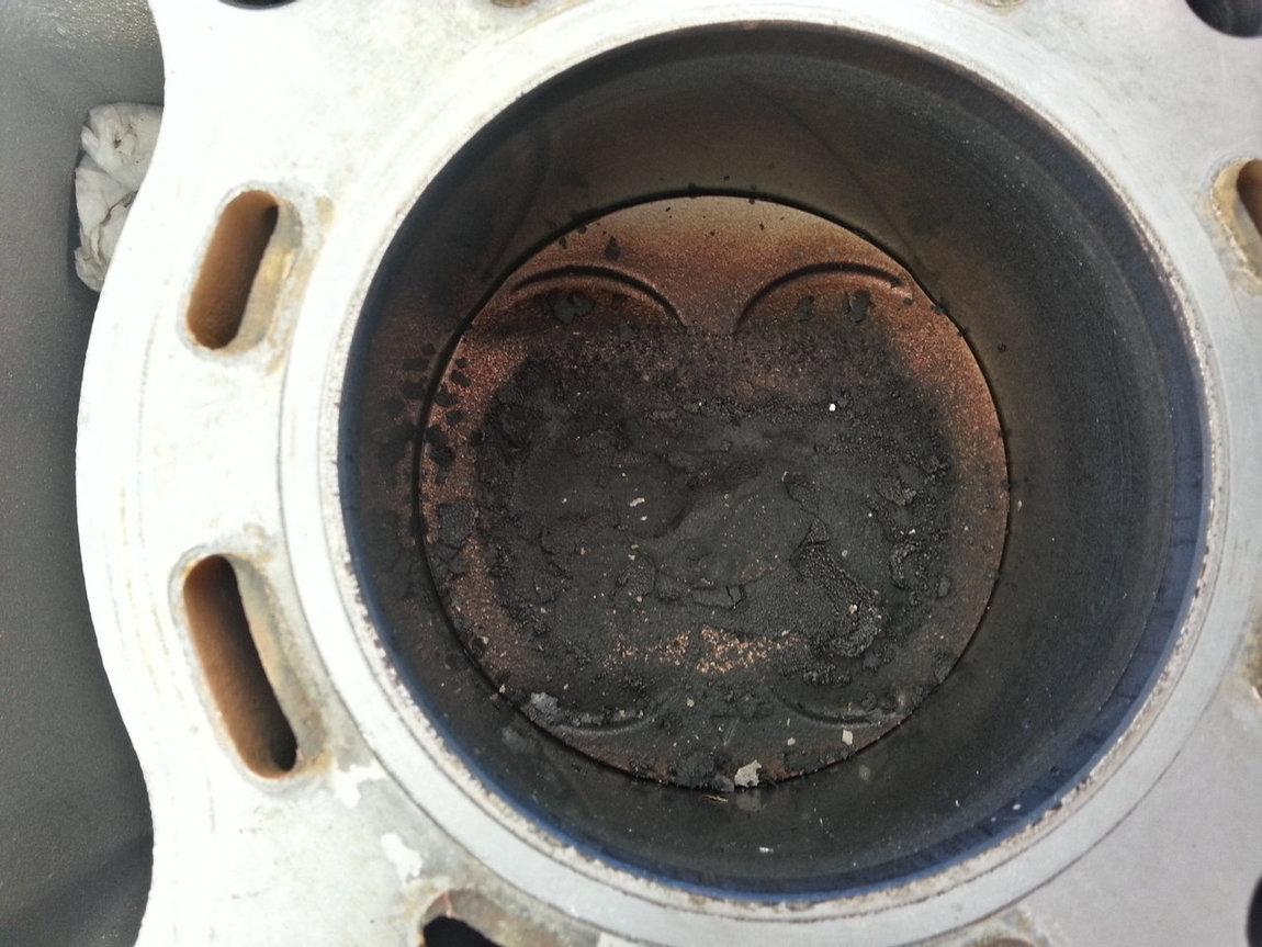

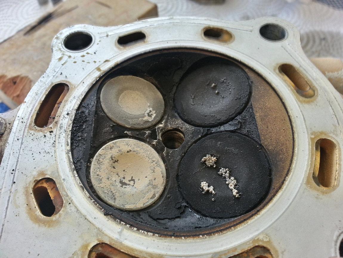

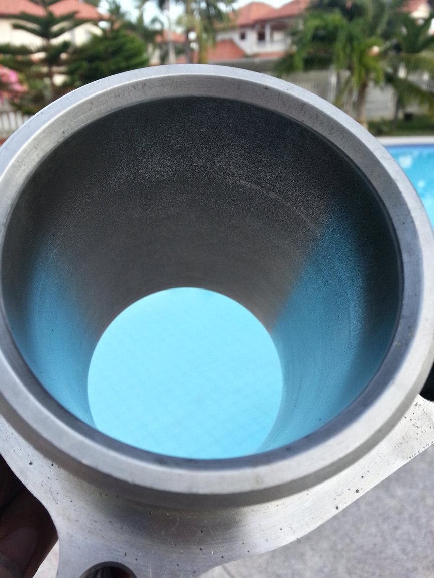

    3) The piston rings were worn, piston had a lot of deposits, valves had a lot of deposits, the exhaust valves had deep pitting and their seats also had minor pitting. The bike definitely had low compression and the cam chain was noisy.
    I got a new piston, rings and pin a while ago, I got a local mechanic deglaze&hone the cylinder for me, actually with this cylinder and the new piston and rings the clearances and ring end gaps are pretty loose, still within service limit but not that good. However having no spare cylinder - and a new one is not on the budget for now - I decided to install things as is and hope it will last long enough until I get another cylinder. New exhaust valves, cleaned the intake valves, my wife did the valve lapping, new valve stem seals, cam chain and tensioners, put in a krieger manual cam chain tensioner as well. Did the Marcelino cam timing mod, disabled ACR with a bent piece of thick steel wire replacing the ACR spring.
