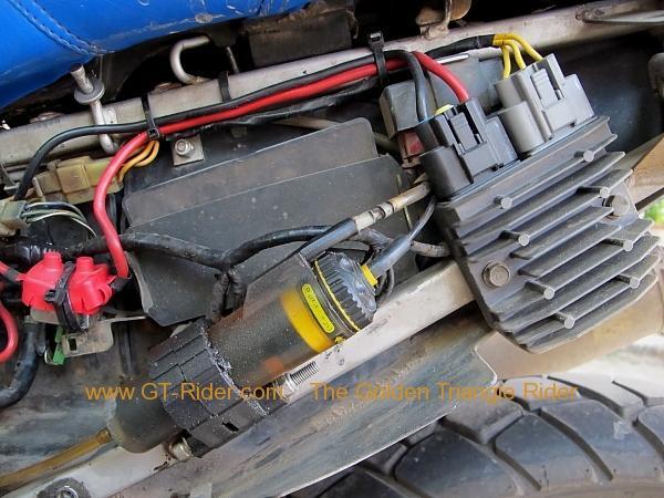

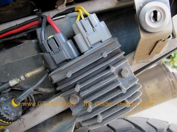

Maybe this does not apply but many moons ago I was running a Superfour and went through two regulators. I was told it was the heat of this country that was bad for them and that I should think about mounting them to get as much airflow as possible over them. Anyway to replace them I went to a bike shop and waited and waited for them to source a second hand one. These cost 3,000 baht second hand with no guarantee of how old they were or how long they would last. Then a friend of mine also bought a Superfour and later his regulator went. He went to a Honda dealer here in Chaingmai and they looked at it and said it was the exact same regulator as used in one of the smaller Hondas. Anyway 350 baht for a brand new one. I felt a bit foolish and quite a bit poorer.

Davidfl;268764 wrote: What do you think & recommend.
Well the AT is down again with a faulty regulator. I've got 2 1/2 yrs out of this one I think so can't complain.
What I've ordered in from the USA
FH012AA Mosfet
Regulator
available from
http://www.roadstercycle.com/
Any comments / ideas?
Fitted
a few weeks ago & very happy with the service from
