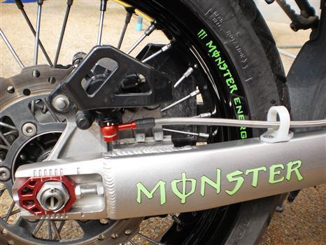

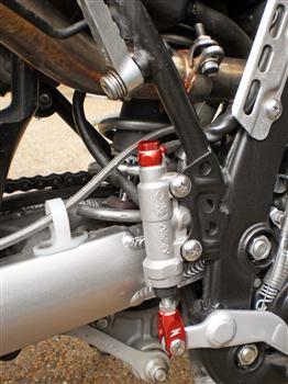

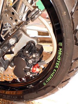

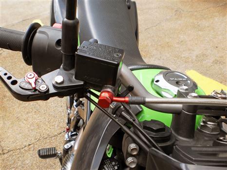

    I got a recommendation for an online company, who distributes for Galfer & the site was so easy to navigate around & choose colors for lines/banjos/bolts etc for my model & year klx250sf. With a easy secure paypal link with option for different shipping address & competitive price, I had to use them (solomotoparts)USA. Will update this post with how long or short they take to deliver to Thailand!!
    8 days to deliver to Thailand from the US.....wow [​IMG]
    Everything I ordered was correct & hoses fitted perfectly. Galfer is a high quality product & half the price of ordering from Japan!
    I ordered clear plastic coating (they have many colors to choose from) on the steel hoses with red banjos & red nuts.

    Hope this helps anyone interested in braided steel upgrade hoses that look gooood ;)

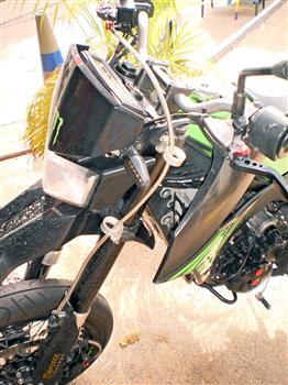

    Last picture about these hoses. I was pm'd by a member about why my hoses don't have the mid section protective pvc section, like they are shown on the website. Well, I cut them off is the short answer! In hindsight I would have asked the company to take the plastic sheath off the hoses before assembling with the banjos as it took about 30mins per hose to remove. BTW the clear coating on the steel is still intact & perfect after removing the guard plastic. If I was a hardcore offroad rider then it would be better to not cut the heavy duty pvc protectors off.
