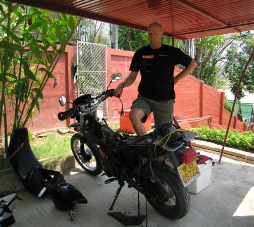

    Finally after endless work, the bike is now ready for China. Was amazed at the extent of work needed to get it ready, in light of the fact the bike is less than a year old......Lhasa and Shiangra-La, here I come !!
    These photos should also strike a bit of fear into David's heart. Have not yet decided on what I want to spend his 1000 baht bet that I will not make it into China.

  10. rhiekel
    rhiekel Ol'Timer
    1. Replace rear wheel bearings
    2. Replace chain, sprockets not available here. Have to wait until
    China to buy them.
    3. Repaint all the plastic parts. They were off anyway for the general
    rebuild so not that big a deal to paint them.
    4. Broken mount for the right handguard, weld together and paint.
    5. Rear subframe completely broken. Cut out the steel rebar used
    to fix it at some farmer's shop in China, and weld in steel plates
    that now make it stronger than new.
    6. Replace the goofy looking front fender with a Honda one. Was pretty
    seriously style impaired before.
    7. Re-foam and recover the seat. Was a torture device before.
    8. Speedo was broken. Pulled it off and put on digital tripmeter I had
    laying in my parts bin.
    9. Replaced all the turn signal indicators as they were broken or
    hanging down.
    10.New rear view mirrors.
    11.Make up steel racks to hold the soft bags from the side of the bike
    12.Fabricate up a flat rear cargo rack from aluminum.
    13.Seal all the valve cover plates that were weeping oil .
    14.Install power supply and mount for my garmin 276 gps
    15.Craypot is right the brakes were pretty wimpy. Pulled the entire
    system apart, cleaned it, and fresh brake fluid. Works much better.
    16.Tear the carb apart as the bike had a serious high speed miss all
    the way back from Laos. The main jet was plugged with dirt.
    17.Installed a cleanable fuel filter. The bike did not have a filter..
    18.Fuel tank was full of crap so clean that out
    19.Put on a louder horn off one of my Africa Twins.
    20.Right foot peg was bent off at a weird angle, cut it off completely
    and weld it back on straight.
    21.Stock grips were about as thick as paper. Pulled those off and put
    on some new ones.
    22.The rear taillight did not work. Had to trace out the entire wire
    loom to finally find a break from a bad connection in the middle
    of the loom.
    Other than a bit of work, a fine bike.........

    Ian the bike is a Zong Shen bike made and sold in China. 200 CC four stroke, 14 raw blazing horsepower.....
