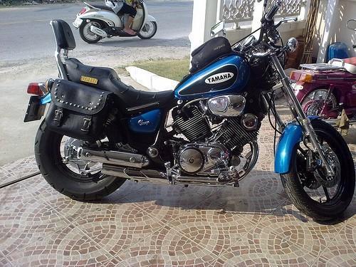

    here somepics :
    [​IMG]
    [​IMG]
    [​IMG]

    Reinhard, powedercoat on the engine ??? :? Just from physics: black absorbs, silver reflects heat (something about waves, too long ago I can't exactly remember.... :cry: ). Just consider your aircooled shaker twin and then adding some more heatabsorbing coat, wouldn't do that...... :lol: . A beauty she is !! Are you coming up to CNX any time soon ?? Cheers, FRanz

    Franz, i am not sure what to do with that paint on the engine..it is black paint already and it happens that i spilled some fuel on it and that black went off...so i am sure open to suggestions...the bike is lovely and the engine sounds right too.....i believe that it will need for new(or well kept) shocks too..not hat the bike handles bad at all and having done a 150 kph ( gps verified) on it yesterday ,but ran out of road to continue ( i assume a 165-170 is max) ,i can say that it handled it alright and a 750cc is an displacement size i have always liked on bikes....
    I wouldn't mind to have my old "chick" dancing a "strip tease" to show me whats under and fix things needed...so i have a trouble-free bike for a couple of years onwards. I am not so much of a mechanic ( although i do have some basic understanding of things)so i would need to find somebody who know how to rejuvenate this "chick" ...for now i am gathering info and things that i need...

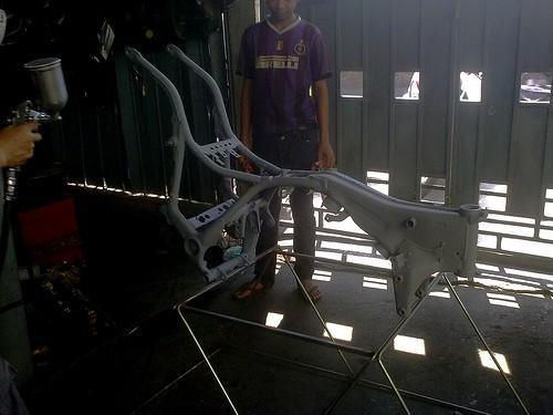

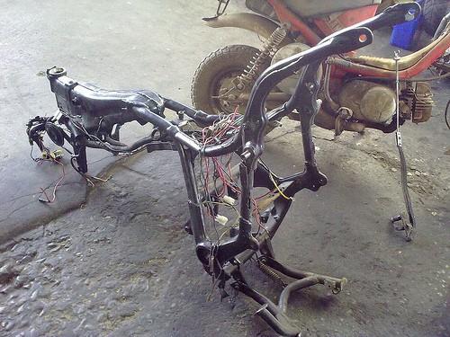

    As mentioned before i bought myself an "all legal" Yamaha Virago XV 750 . It is an older bike but i like the v-twin and as cruiser/copper style bike it is quite nice and very comfortable with adequate power . It si currently stripped down and here is just the start of it.
    here the frame after stripping it:
    [​IMG]
    and this is the frame today:
    [​IMG]
    pretty much i can show for now but more to come as time moves on...
    happy trails,
    mbox

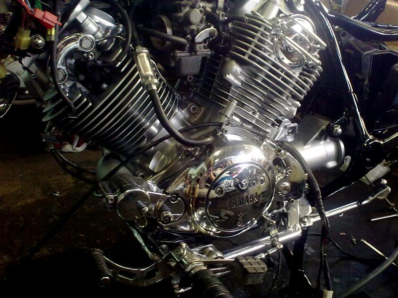

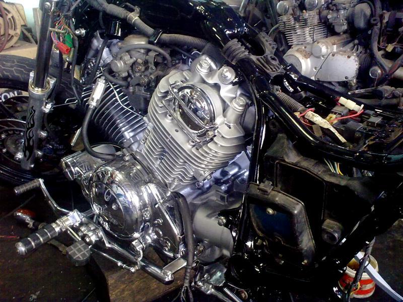

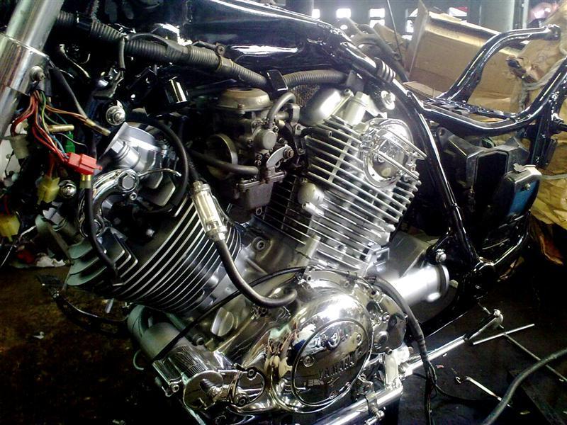

    A few days gone and the engine has been checked and cleaned and all the black paint removed ,and i have seen that last time ...but he painted it with aluminium-alike paint again ( at least he used one of those resistant to high temperature...), not really my plan but it actually looks quite nice. He found some new switches and some other things...a different exhaust will also be added and the motocross handlebar will be exchanged to some "regular" handlebar ( but not the chopper style really...more a straight bar)
    Here some pics of today.
    [​IMG]
    [​IMG]
    [​IMG]
    There are some parts en-route to be mounted too ...and Mr.Oor ( thats the mechanics name) said he shall have it all ready by next wednesday. This would be a real surprise to have it so soon but i believe it when i see it.
    Happy trails,
    mbox

    Reinhard, looks nice :happy2: though one comment, after seeing the shiny engine covers :thumbup: , couldn't the 'mechanic' :sad1:: also have cleaned up the carbs a little ??? :thumbdown: . Cheers, Franz
  22. mbox999
    mbox999 Ol'Timer
    You're right Franz...and i think i will talk to him about that Carb too.The funny thing really is...the more things are checked on the bike the more things we find that need to be fixed...the initial plan of the mechanic was to be ready by songkran and i do know he did work hard on this because i visit almost daily now. But we also agreed that this is not possible ...nor do i want to rush him really. Somethings that where planned to be done simply where calling for alternatives or "leave as is until we find the good looking one(replacement part)" . This is just an example:Yesterday the shaftdrive was checked...no oil inside but all in order and he got a new seal arranged now so the oil stays where it should. The mechanical things and the wiring will be the most important and i am really glad we stripped her down and get it sorted.

    Reinhard, one basic 'law' for restoring bikes: "looks worn or condition is doubtful, always replace", so when doing the shaftdrive and replacing the seals, bearings are not expensive and hard to come by in LOS, their exchange would be a must...... :lol: .......otherwise I see someone being sorry soon....... :wink: , cheers, Franz
  24. mbox999
    mbox999 Ol'Timer
    Yes, actually the bearings were exchanged too .
    not sure what to do about the carb looks actually...sure the engine shines and the carb doesn't ,but as mentioned before the engine got a layer of heatresistant paint. Should i consider having the same paint to be used for the carb?
    mbox

    NO, no paint on the carbs !!!!
    Tell the mechanic to clean both carbs really carefully on both the outside AND the inside with petrol, compressed air and cottonbuds !!
    Tasks: check if the floats press on the needle in the right position and close off the petrol flow into the carb bowls. Check the closing needles for wear. Check all jets and clean them with compressed air only. Very important to have the pilot jets cleaned, both for petrol and airflow. Check that the idle mixture srews are clean and set to the right 'turns out'. Should do this according to repair manual settings. Further on if the carbs are flatbed, need to check for wear on the slides, cracks on the diaphragms and that all seals and O-rings are ok. Needles should be set at the right recommended position. Choke valve should be clean and show no wear. Intake scoops from Carbs to cylinder head should be absolutely tight and not allow additional air to be sucked into the engine. Synchronisation is an absolute must. If you don't have any settings, just type the carb make and type into Google and some sites with forums will come up where you are provided with information on how to do. I did that with my Mikuni BST40 on the DR650 recently although mine is now fitted with Supertrapp exhaust, K&N filter and DYNOJET stage 2 kit. Be aware that your jets are not meesed up and original size, need to look at them through magnifying glass. Cheers & happy working, Franz
