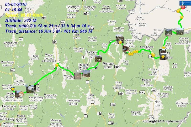

    I took my WPL-2000 on a 12 days Laos trip. Globally, it fulfilled my expectations. A couple of question marks were linked to my inexperience with this “gadget”, the remaining ones are merely small annoyances.
    Out of the box.

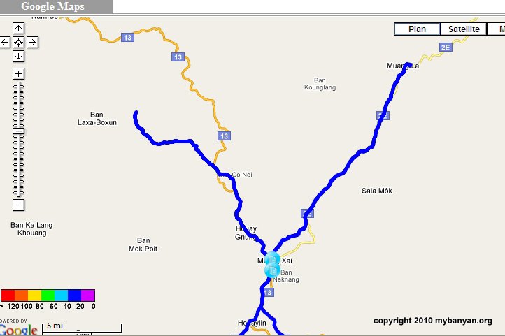

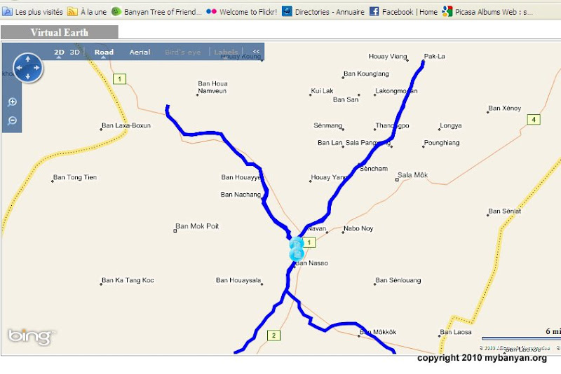

    The trip was accurately recorded. I found small visualization differences between Microsoft “Virtual Earth” and “Google maps”, at least on one sector, where Google did not follow exactly the road. Such differences might be linked to the map's consistency.
    The track generated by Virtual Earth
    The same data generate a slightly “off road” sector with Google Maps

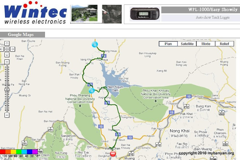

    It is handy to export log data in various output formats. The possibilities should cover most needs, with files such as Google Maps (html/xml), Google Earth (kmz), Virtual Earth (htm), GPX (sgpx and gpx), Excel (csv), UTM (txt) and 6 other formats. This versatility allows to compare different visualization possibilities and covers many processing needs.
    Trip statistics are nice benchmarks for travelers. Altitude, distance, driving time and average speed are permanently computed. After 360 km there was only a 10 km difference between the WPL-2000 recorded distance and the motorcycle's odometer. Unfortunately, I had no idea how to reset the daily counter, without a computer an without loosing the data of the tracks (maybe it is just not possible).
    Back home, I generated the maps of the trip. The itinerary was cut in segments, but all were available for visualization. I still have to decide a procedure to make the “cutting” coherent (probably cutting by day of travel). There were also cuts when batteries were exhausted.
    Geotagging “jpeg” pictures (not RAW) is straightforward, as described at the beginning of this thread. The localization data are automatically included in the exif data and the pictures can be viewed in thumbnails format on various types of maps.
    The program, included on the tracker's USB stick (win_tool.exe), automatically generates a backup of the data on the host computer (in the folder: “my documents / easy_showily_log_data”). The files are named “backup_(date).TES”. If necessary, they can be re-imported to the win_tool software (launched from the stick), to generate other reports or for further geotagging purposes.
    An additional free software called TimeMachineX can be downloaded. I have not yet experimented it, but it allows to “manipulate” the data, and to change the layout of the itinerary. Various trip reports can also be generated.

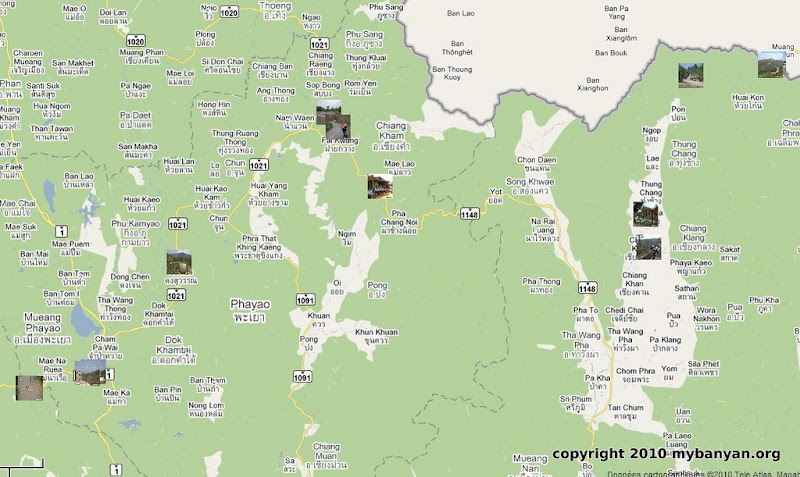

    Maps with thumbnails of pictures

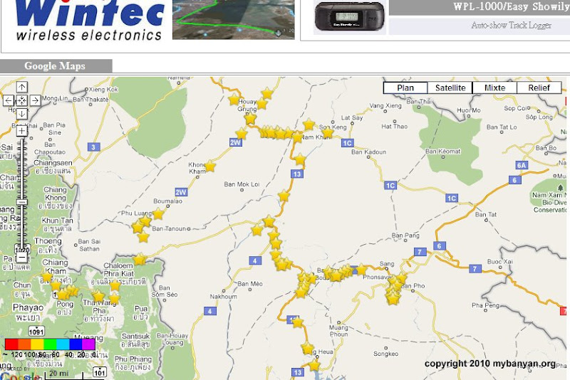

    Track points itinerary
