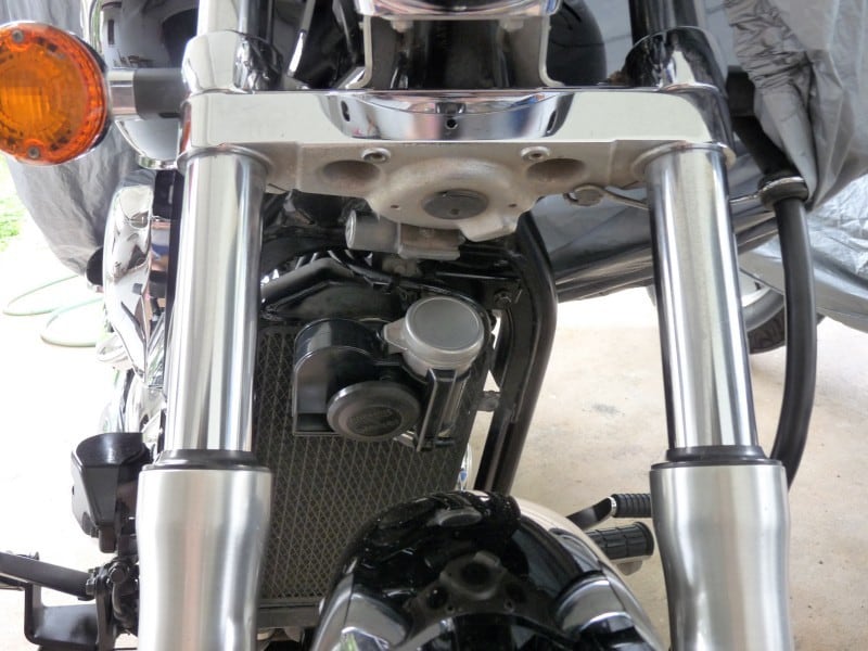

    The dinky little horns factory-fitted to most big bikes are little more than a liability. When trouble looms, you want a seriously loud noise to get the offender's attention FAST! I stumbled across a reference to Stebel's motorcycle air horns whilst looking for a new helmet on Ebay. There are many online sellers, I got mine from Motohorns (info@motohorns.com).
    The Stebel Nautilus air horn draws more power than the factory unit fitted to your bike, but still needs to be connected to the existing wiring / horn button on the bike. Preventing any electrical issues arising requires a voltage regulator and fuse to be installed. The cheapest / fastest way to achieve all this is to buy the horn complete with an "Easy to install Plug'n'Play wiring Kit Included."
    This comes pre-assembled with everything required to connect the horn to the battery, and thence to the existing horn's wiring, and includes a regulator, fuse assembly and even 5 cable ties! I'm far from being a mechanic, but the supplied instructions were well-written and easily understood. No joining, soldering or modifications to anything at all were required to connect the unit up on my Kawasaki Vulcan! It was almost TOO easy, and everything worked the first time!
    NB: Not all the wiring kits for sale are pre-assembled / plug 'n play - some have all the components but YOU have to join everything together.
    The unit bolted to the original horn's factory bracket, and is now tucked neatly away.... The bracket really requires a little "twist' to ensure the horn never quite touches the radiator's protective grille, and I'll get that done before long.

    I installed one of these bad boys on my Versys about a month ago and fark me is it LOUD!
    I'm quite amazed that something so small can be so loud!
    It's so loud in fact that I've put the baffle back into my exhaust, because this horn is all I need.
    The reactions you get when you toot this horn are pretty funny.
    Got mine on Amazon along with the wiring kit- quick delivery, easy installation.

    Stebel Nautilus Air Horn on Kawasaki Versys-
    This horn is so loud I put the baffle back into my exhaust!
