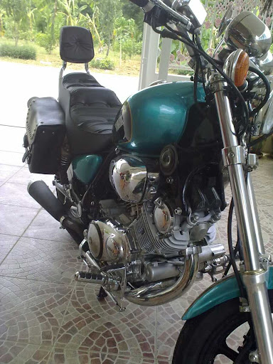

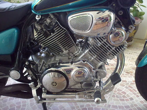

Re: Yamaha Virago XV 750
Postby mbox999 » 19.04.2010, 21:52
Hi there,
Thanks for the feedbacks. Looking forward to be on the road with it soon too :happy1: ...but somehow the time to finish keeps stretching. It's kind of normal here though :think: . Anyways here some pics of today .Still the Carb to be polished(at least i tried to get it to understand to Mr. Oor (mechanic))-some parts we are waiting for and quite a bit of work ahead .

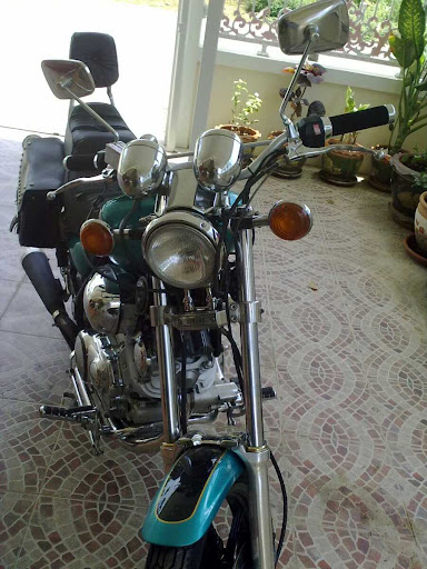

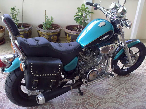

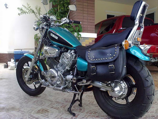

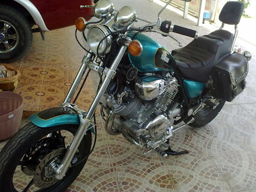

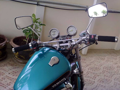

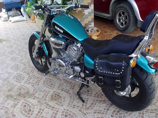

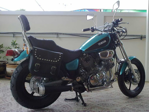

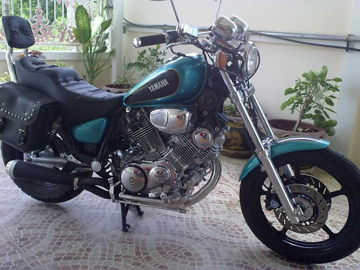

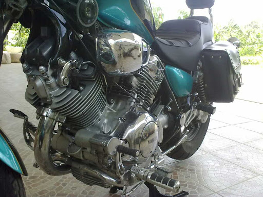

Postby mbox999 » 13.07.2010, 18:32
Here some pics of my soon finishing Virago Xv750 . As you can see it has the new paint the Motor is not black anymore...there is a new exhaust ( custom-handmade) lot of things has been done that aren't visible but were rather technical(new clutch, new generator stator, new pulse generator, new wiring ...) . There are still some cosmetic parts to be fitted/exchanged but they will be sourced over time from secondhand bikes. Looking forward to be on the road soon.
Postby Davidfl » 13.07.2010, 18:45
That looks like a sweet bike now with lots of TLC. I bet you're happy. :thumbup:
Postby Franz » 13.07.2010, 20:07
And a nice one she was tranferred into..............
I like the colour and also the custom made muffler !!
Must have a throaty sound, good, so all dogs, chicken, Waves and kids can hear & run :mrgreen: .
So when's the first ride up to CNX ?? BTW where's the plate ???? rgds, FR

Postby mbox999 » 13.07.2010, 20:20
Franz wrote:And a nice one she was tranferred into..............
Thanks Franz & David , I am very happy to have it close to finish...the last 3 spareparts just arrived from the US and shall be installed by tomorrow ( generator stator, pulse generator & startergear)...although the startergear looked a bit different as i remembered it , but the mechanic said it looks right . So hopefully i am wrong and the mechanic right. The exhaust sounds really nice now it was well made with the exception of the paint itself. I asked for a heat resistant color repaint , although not sure if maybe something else such as powdercoating could be better.

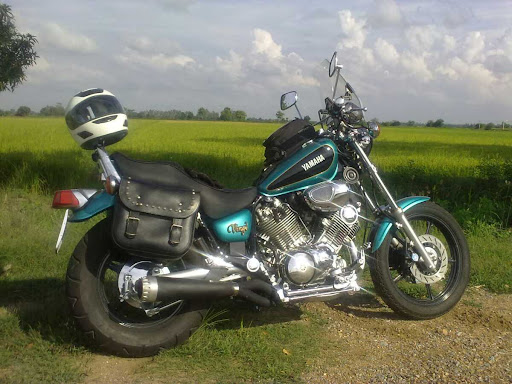

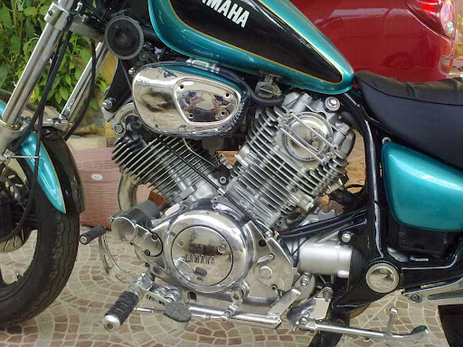

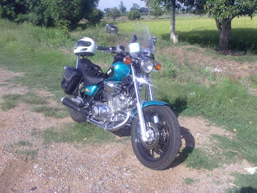

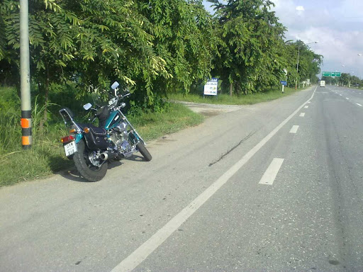

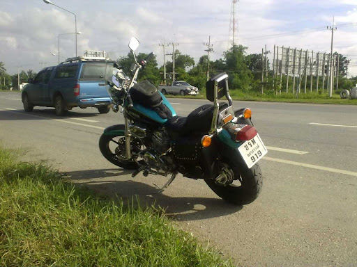

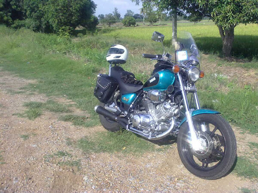

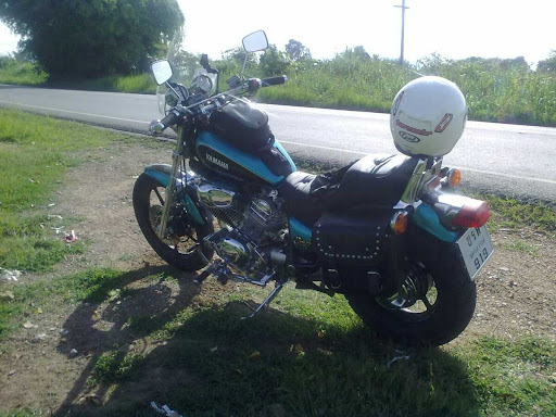

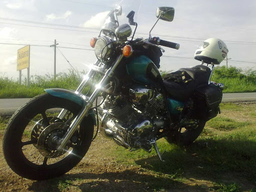

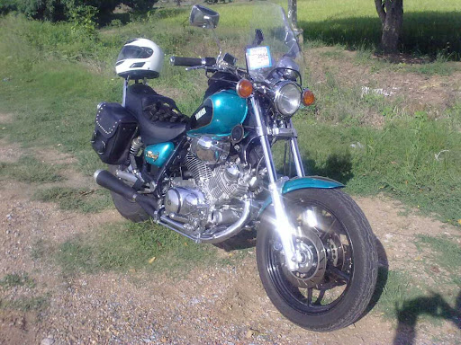

Postby mbox999 » 17.08.2010, 20:54
I made a little trip today and made some pics of my Virago 750.
The quality of the pics is so-so as i took them from my nokia e75
happy trails,
mbox
Postby Captain_Slash » 18.08.2010, 04:12
You certainly made a good job of it as it looks great
Postby mbox999 » 19.08.2010, 18:49
Captain_Slash wrote:You certainly made a good job of it as it looks great
Thanks colin, it feels great too, but it is an 25 year old Lady and i assume there will always be bits and pieces to be exchange or fixed...but the basics are fine ( me thinks).
Not sure what i must think of the custom made exhaust ...i like the looks and the sound is crazy but also quite loud...i ride on trips longer than 30km's with earplugs, and when i pass on parked Cars their alarm would go off :shock:
