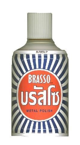

    [​IMG]
    Can't find it?
    Brasso is in 7/11 here in BKK.
    [​IMG]

    Found Brasso yesterday at Big C, but I'm still shopping around. Most of the products I found in the automotive area were about cleaning tires, not chrome wheels.
    I will look for the Autosol. Thanks!

    You guys would not believe ... well, maybe you would. I've been to nine different places in UTH looking for chrome cleaners. Not even the shops that sell tires and wheels have it, but man, they've got 80 million different kinds of leather cleaner and tire shine products.
    [​IMG]
    So far, Brasso is all that I've been able to find.
