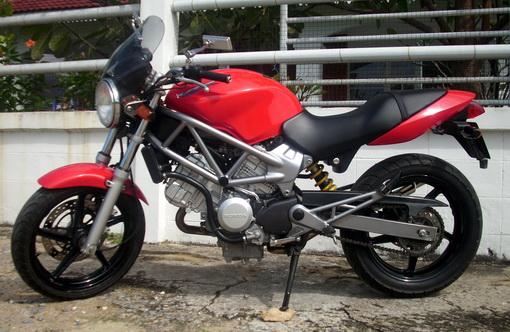

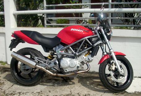

KZ25;304460 wrote: Small VTR or big VTR?
Yes there was the VTR250 but don't think I have ever even seen one - no mine was the full fat 1000cc. It was a great bike, massive torque, slim and being a twin did not have to rev it like a four.
KZ25
Nov 19, 2011
805
I had a couple of the small ones - loved them! You could rev the hell out of them and still do somewhat legal speeds.
Quite a bit more power and maybe even lighter than the CBR250! They should have brought that one over...
Jul 20, 2013
87
KZ25;304463 wrote: I had a couple of the small ones - loved them! You could rev the hell out of them and still do somewhat legal speeds.
Yes now see your snaps remember seeing one somewhere in Asia, is it still in production? Looks nice would like to have a go on one. Yes as you say more power and similar weight than the CBR/CRF250. Want to use my M on some light trails or just have bit more grip when minor road goes to dirt say 80 / 90 % on road but want to retain good road rain riding. Looking at replacing stock tyres with either Scorpion Trails or MT60 - the first look only slightly off road where as the MT's look bit too off road and possibly sacrifice rain tarmac grip. There is an RS version of the MT which I think is super soft but not in size that will fit the rear. I asked this in another post and no one came up with any suggestions, you have had your M for some time so what is your opinion?
