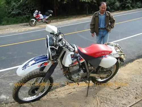

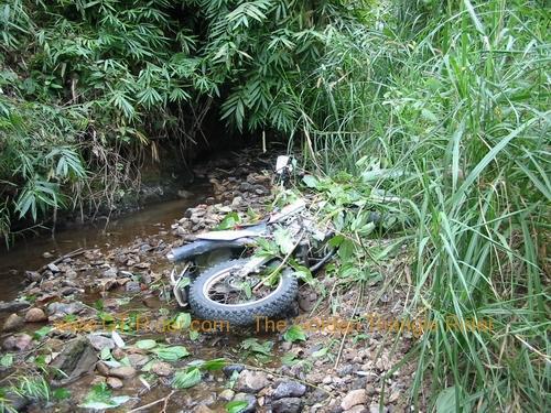

I’ve pulled a Jap rider out from going over the edge on R1234, the Kiu Sataa – Doi Mae Salong road. He suffered a broken back. Within 24 hrs we had him in Ram hospital in Chiang Mai & operated on. 6 weeks later he was walking & back in Japan. He was the best rider in the group, but the last one at the time & we think was trying to catch up, not knowing we had stopped up the road to wait. He misjudged a corner & over the edge he went. I had to get the police, an ambulance, 2 nurse + 6 Akha guys with machetes to find him; then follow up at hospitals in Mae Chan – Chiang Rai – Chiang Mai, all in 24 hrs.
Standing at the spot where the rider went over the edge, you would never know that a rider & motorbike had crashed through there - no marks whatsoever! So stay in sight of one another.
Check out these photos...
