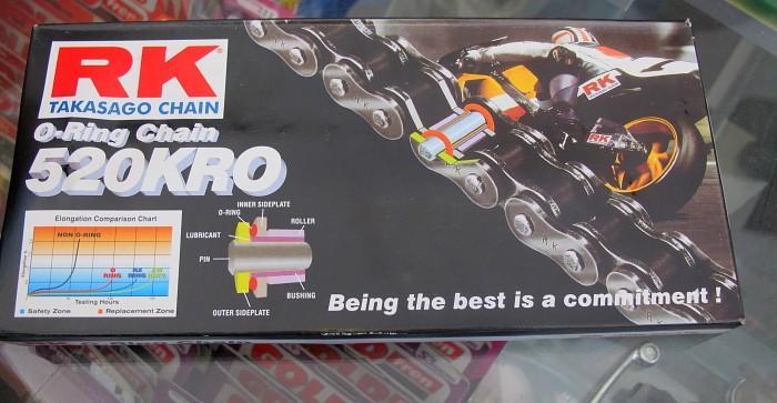

Yes most of the DID chains are made in Thailand and they are cheap and no good.
Yesterday I was in Kawasaki Chiangmai and they had a RK-O Ring chain which is a good chain.
Don't know if you are in the area but if you are may be you could check it out.
Last time I was in Australia I ordered an RK - X Ring chain and JT Sprockets which are quality they cost twice the price of the Thai ones made here but for 3500 baht fitted you cannot complain about the price here only the quality.
You may have to out source Thailand for quality sprockets but you can find EK Japanese chains here which are good but its no good putting a chain on sub standard sprockets as the chain will be not to bad but your sprockets will still wear out at the same rate and even though the chain may seem OK you will have to replace it.

What I used on the Versys today.
cost 3,600 baht.
Ordered before Christmas. I was after X-Ring chain but was told I;d have to wait until the end of January; so I took what I could get.
The 2,000 baht EK chain I put on as an emergency chain in Phrae a few weeks ago, actually looks quite good still.
