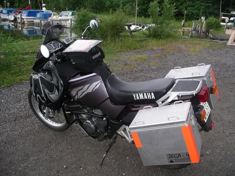

Congrats to the new Project....i think i would take a spin with you if you had a pink xtz 750 - however i would come along with my red/white "Austro-Retro" with g-whips :-)
You can add a lot of luggage on that xtz 750 too....but with pink you would have to make the luggagae case also color matching :-)
If you keep the color as now here some fully loaded xtz 750:
