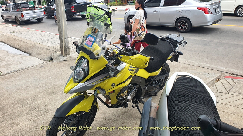

The Vstrom in the shop has some issues.
There is a noise coming from under the tank / top the motor.
It resembles a "clacking," "clackety-clack" sound - a cam chain or a tensioner?
Ride the bike at a steady 30 to 40 km/h, and you cannot hear it.
Only when the throttle is closing can you hear it.
Place the bike on the centre stand and run the engine in both gear and neutral, and you are unable to replicate the sound. Everything is normal.
You can only hear the sound when riding the bike.
The front sprocket checks out all ok.
The mechanic has removed the cam chain covers to check the cam chains and tensioner.
Everything is ok he says.
If you run the bike engine for 20 minutes, get it hot, you still cannot replicate any unusual sounds. Everything sounds normal.
So, my only suggestion now is to dump the engine oil & check for any excess metal.
Any ideas - what or where to look next?
I'm mystified by all this as this is my 3rd 650 Vstrom & have 300,000 kms trouble-free mechanical kms up so far.
Vstrom # 1 had 190,000 kms on the clock when i sold it.
Bulletproof. Absolutely 100% standard motor. Only ever changed engine oil & filter, spark plugs, air filter. It never burned any oil.
Vstrom # 2 was the same, sold it at 90,000 kms. Zero mechanical issues.
Vstrom # 3, bought 3rd hand, has been reliable the same too. Until a few days ago riding home in the dark.

Damn I thought this sounded just like it, BUT we could not replicate the sound with the bike on the centre stand and engine running.
Although Kong the Mechanic in Chiang Rai agreed the sound seemed to be coming from under the tank top of the motor when test riding the bike at 30-40 kph.

At Kong's the bike is parked outside in the street, ready to go.
What I thought?
You can't have done cam chains & tensioners without parts already, could you?
No.
I just replaced the front wheel bearing. It was totally knackered. Adjusted the steering head bearing. Replaced the rear sprocket bearing.
Checked and cleaned the front brakes that were giving you trouble.
Please take the bike for a test ride. There is definitely no engine noise now, & the bike is running smoothly as ever.
WTF, I thought. Impossible. We both agreed the noise was coming from under the tank/top of the motor???
I spoke with the Suzuki chang in Chiang Mai and we both thought it couldn't be the cam chain.
So I discounted the engine & looked elsewhere first.
Yes, but we both agreed the noise was coming from under the tank.
Right, but I replaced the front wheel bearing & there's no noise now at 30-40 km/h. Please go & test ride the bike.
So I did. No noise & I still can't believe it!
