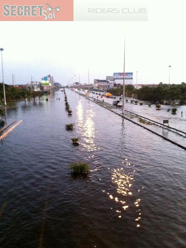

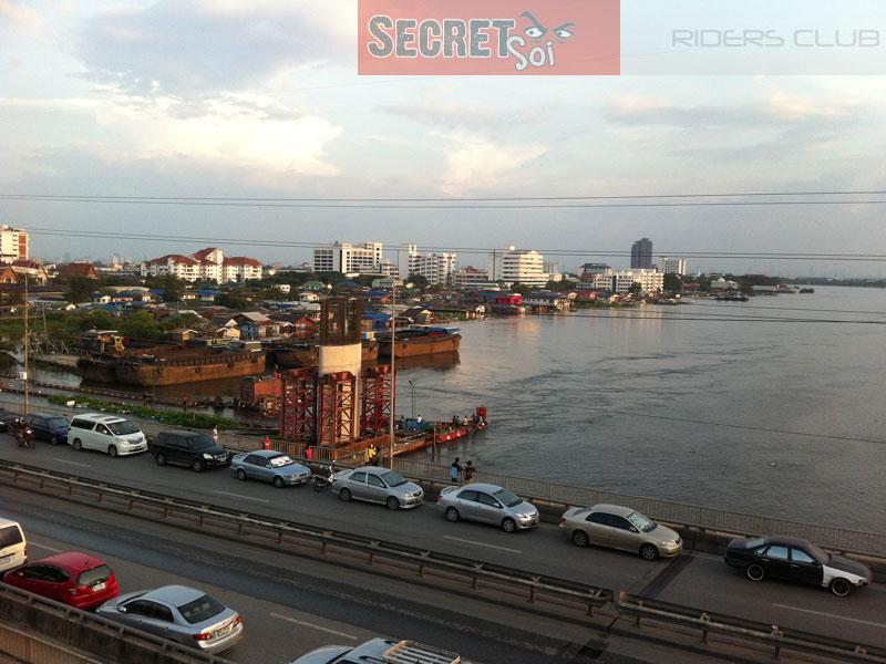

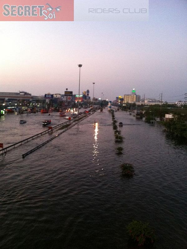

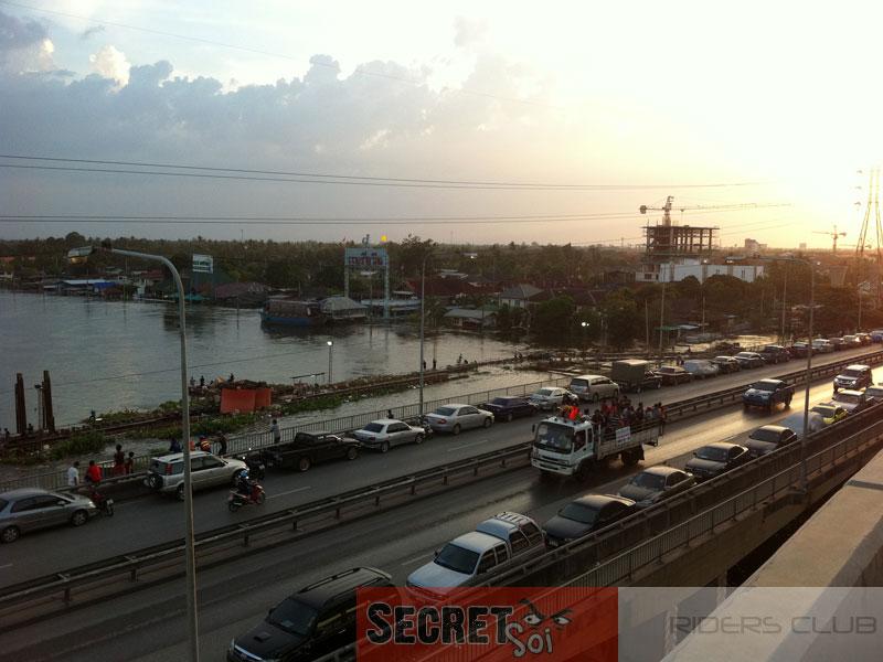

The Chao Phraya has flooded its banks here on both sides. Views from the bridge-

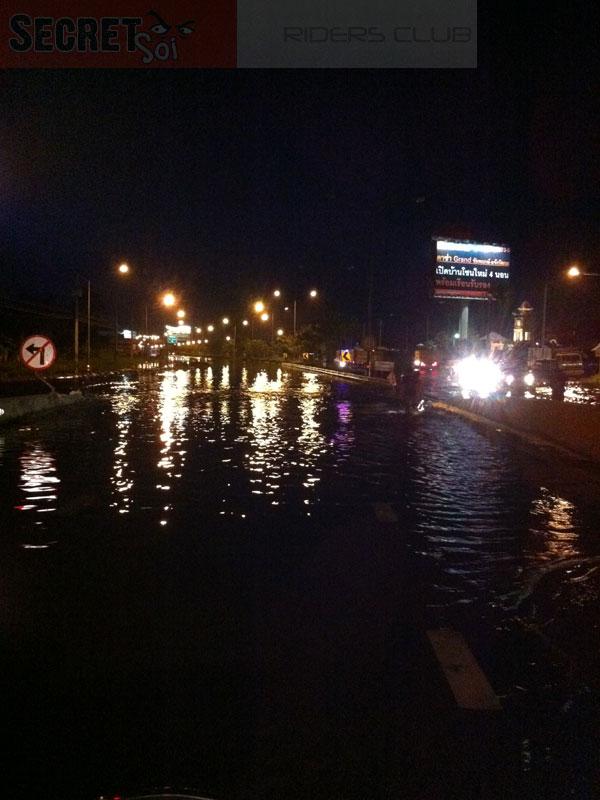

On the 23rd you couldn't go west of the bridge. It looked like this:

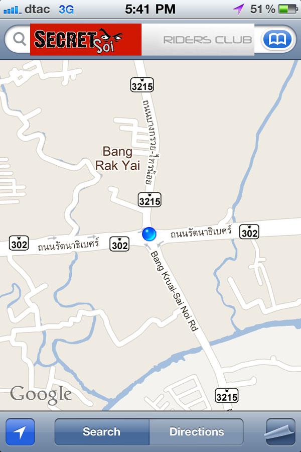

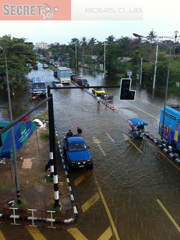

Yesterday it was dry until the junction with Bang Kruai Sai Noi Road (3215).
Bang Keuai Sai Noi road is still flooded, but vehicles can get through-
The water got deeper as I continued west on the 302 / Rattanatibet. I was trying to reach the Western Outer Ring Road (Kanchanapisek)(Highway 9).
Well, I made it (on foot)
Looking south:
Looking north:
Looking east:

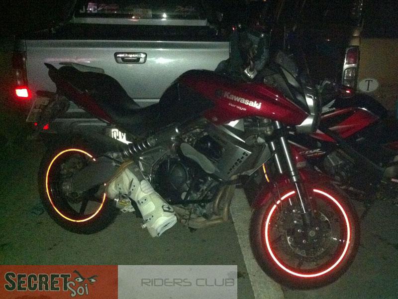

Bike wouldn't start. Wouldn't even turn over. Exhaust full of water, and water in the engine.
Just as I was thinking I'd have to leave the bike there and take an army truck out some super friendly Thai guys offered me a lift back to Kaerai in their pickup
Khob khun maak maak!

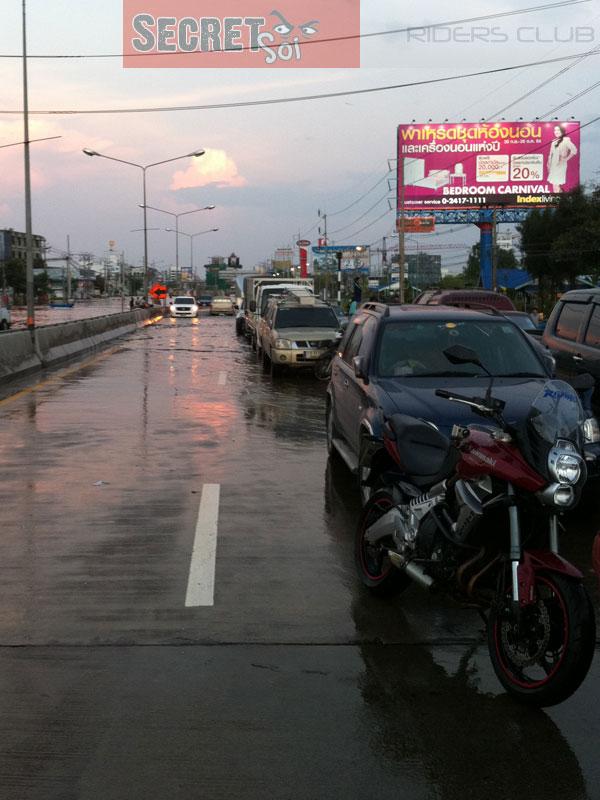

Crappy pic taken while sitting on the bike in the back of the pickup
Once out of the flood zone we were able to bump start the bike and I made it home without any further drama
Today need to change oil and filter and open up the airbox to see if it took in any water. Will pull the wheels too to re-grease the bearings as no doubt they are full of water.
Fun fun!

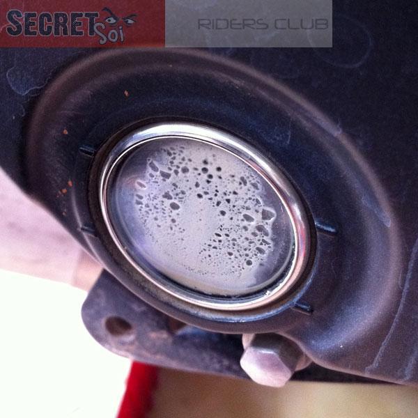

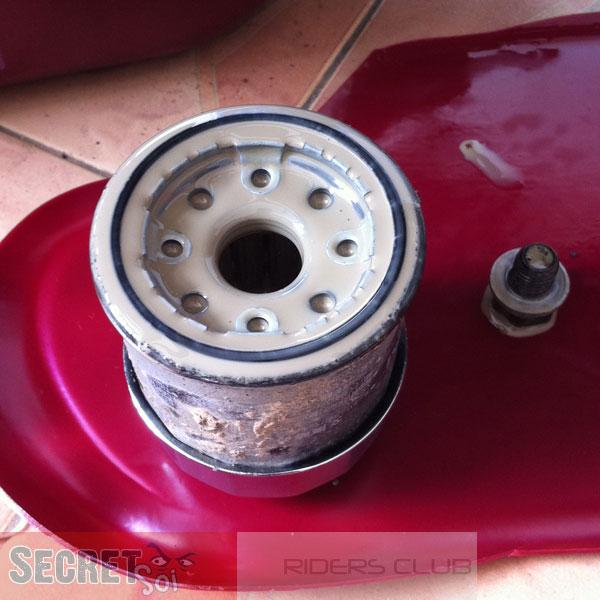

I've never drowned a vehicle before, so not 100% sure what the proper course of action is. I did ride her back from Kaearai to Wang Thong Lang last night- a distance of about ~20km. She ran fine, but I wonder if riding with that much water in the engine could cause any damage?
Site Glass:
Filter:
I expect most of the water got in via the airbox so will open her up and pull the spark plugs and blast away with compressed air, then change oil and filter, take her for a spin, change oil and filter again and see how the oil looks after that.
Anything else I should do?

I've never drowned a bike but have salvaged a couple of drowned marine diesels. We used to drain the sump as soon as they came out of the water then immediately fill them up chock a block with diesel fuel. That was the extent of my involvement though. It was then handed over to the mechanics.
I'd suggest filling her up with diesel first then draining to try and wash out that custard before filling with oil.
Maybe after you've blown out the bores with air you could spray a bit of CRC/RP7 down there then crank it a few times..

I don't recommend riding it till it's completely flushed. Having torn down a flooded engine that had had two oil changes and flushes, and failed within a thousand kms, and there was still plenty of sludge inside the crank and valve train areas. Plus flood waters are full of unhealthy abrasives, I know as it took a good oil bath and scrub to get my chain recovered following all my flood riding (knee deep in front of my house for 3 days).
I have used pure methanol, methyl alcohol, to flush drowned outboard engines and the odd dirt bike dumped in the river well it was running. We add it to the valve train and spark plug holes, plus a good fill in the oil filler - all while turn the engine over by hand only. After draining be sure to fill immeaditaly with oil as your engines insides will be bone dry. You will see the sludge come out the oil drain.
Have also heard of shops using manual transmission fluid as a final flush, as it's lubricating but with far higher solvent, with water, properties than petroleum oils. Never tried that thou

I want to get our and ride this weekend- (The Great Bangkok Evacuation and all that nonsense ;) ). Plan to leave Bangkok tonight with the bike on a trailer, so as much as I probably SHOULD remove the head and really strip her down, but I think I'll go with fish's suggestion of flushing her with transmission fluid, then a couple oil and filter changes and see where that gets me.
