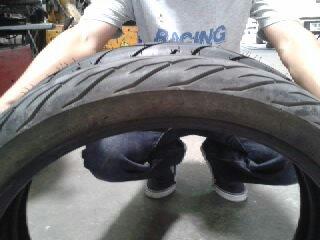

  22. Billy Baht
    Billy Baht Ol'Timer
    Jun 14, 2009
    187
    +0 / 0 / -0
    284158=13351-2012-11-08%2015.30.36.
    Finally!
    New Michelin 110/80-17 arrived today, 60 baht delivery from BKK and 200 baht for mounting and balancing at the Pattaya Gan Yang (Maxxis) tire shop on Sukumvit.
    Time to hit the road! :)
