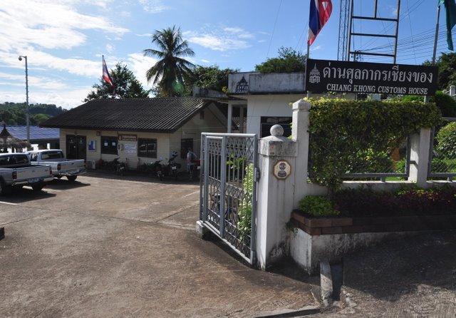

First stop: Chiang Khong Customs Office. This office is on the GTR Golden Triangle Map of Chiang Khong, in the middle of the town near a Wat. Fairly easy to find.
Here we picked up the Simplified Customs Declaration Form. Notice on this form that the valued my bike at twice it's true value, and it also says that if I don't bring the bike back to Thailand within 30 days I have to pay a fine of 1,050,000 baht. Yes, that's over one MILLION baht. Let's hope I don't total the bike or something that would prevent me from bringing it back.

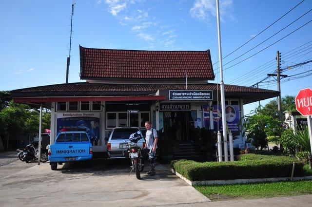

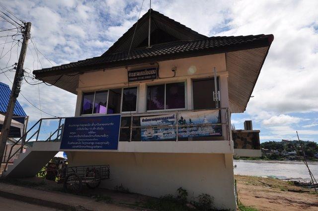

Next stop, Chiang Khong Immigration. I don't think this office was on the GTR map. It's just off the main road through town, a few blocks south of the first office.
Here we picked up the Information of Conveyance form. You will later need a copy of this form, so we asked the girl at the desk to make us a copy and she did. If you don't you will need to find a copy shop in town.

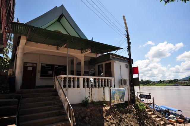

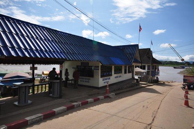

Next stop was outgoing immigration. It's on the GTR map, but in a slightly wrong place. It's on the boat ramp, last building before the water on the left, as you are facing the river. The incoming immigration is on the opposite side of the road. Get your passport stamped out here.
Last stop on the Thai side of the river is the building next door. Here you give them one of the forms you got earlier.

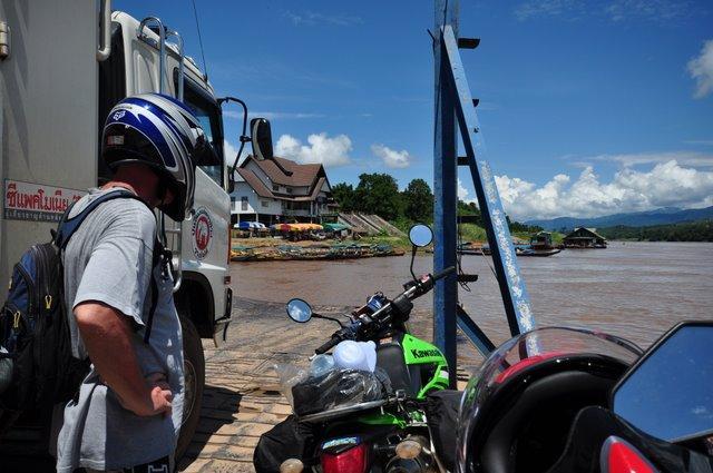

Hurray! The ferry was pulling up just as we finished. Unfortunately there weren't any cars or lorries so Rex and I waited almost 2 hours in the sun before they would let us board. I had a nice farmer tan/burn that day.

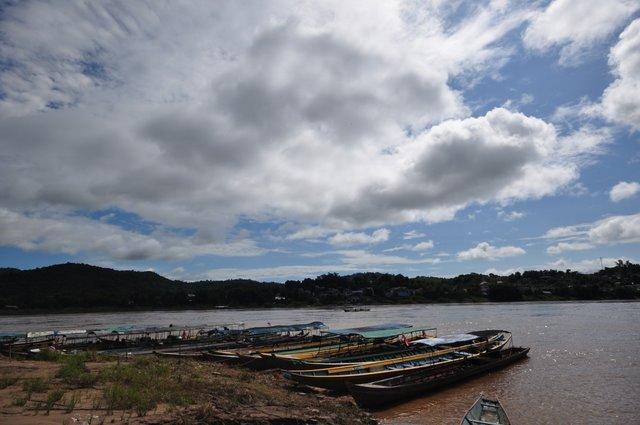

If you want you can load your bike on one of the small boats instead of waiting for the car ferry. Good luck.
Finally we got on, around 1100 am I think. Fee was 500 baht for each of us.

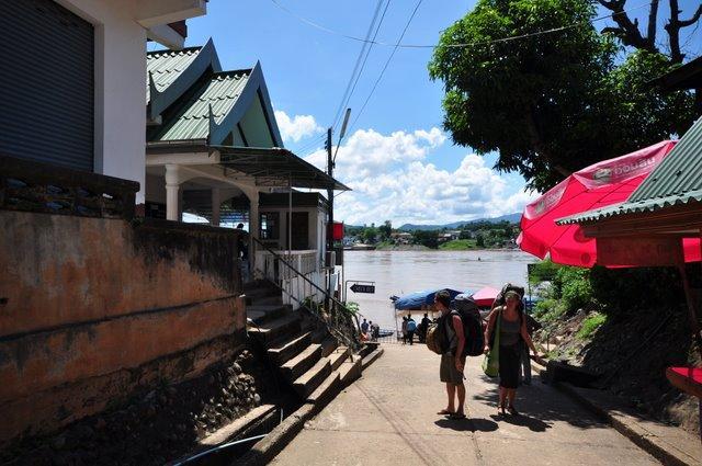

When you arrive on the Houei Xai side of the river, you arrive at the ferry ramp for cars, which is different than the ramp you would arrive at if you took one of small boats like all the backpackers crossing there do. The GTR Laos map has only the non-car boat ramp marked on the Houei Xai map, so don't get confused. You arrive at the car ramp which is a few blocks north of the ramp shown on the map.

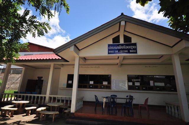

First stop is the Houei Xai Customs House which is not on the map, but is just to the right side of the ramp, on a hill. Go to door #7 which is the one on the left.
Here we picked up the Customs Declaration for Temporary Imported Passenger Vehicle. I think there was a 50 baht fee.

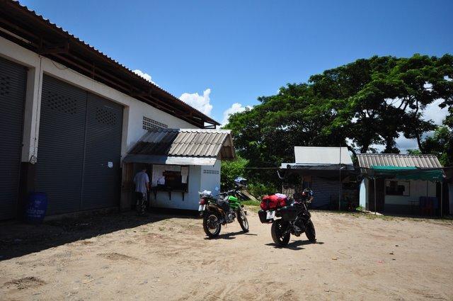

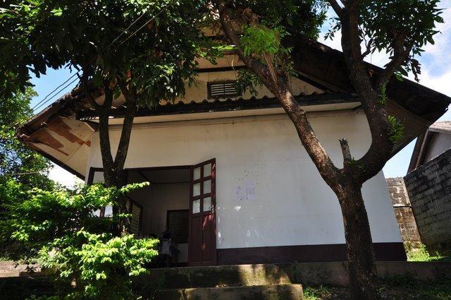

Next up we had to go to some little shack, I have no idea what it is called or what it was for. All they did was give us a signature on the import form without even looking at our bikes. This place was hard to find, lucky Rex was there. It's not on the map, but it's just a few blocks south of the car ramp on the right side of the road down a little alley. It didn't seem to be marked so you will need to drive slowly and keep looking right to spot it.

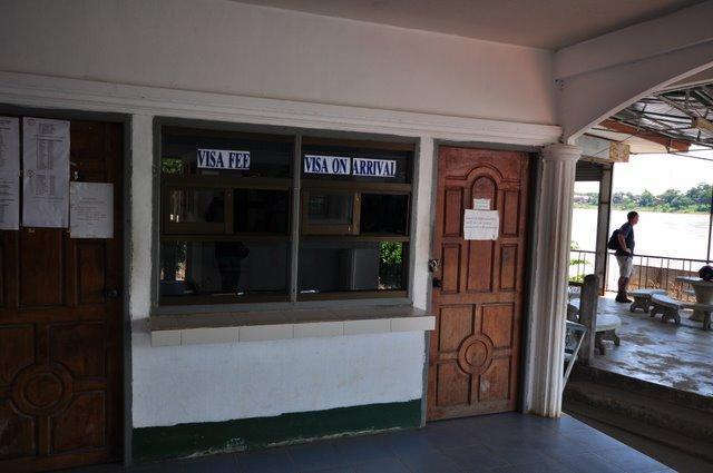

Everything was now closed for lunch so Rex and I had lunch, then at 1300 we went to the Houei Xai immigration office. This is on the GTR map. It's hard to find from the road but it's where all the small boats take the backpackers first.
The guys here are thieves and tried to rip us off. The fee for visa on arrival is 35 dollars, but if you try to pay in Kip or Baht the officer there will charge you 20% or more extra with his F&@ked up conversion rate.
There is a currency exchange booth right there, with bad rates but better than the immigration official was working out on his calculator, so I refused to pay the inflated rate and went to the exchange booth. The guy in the exchange booth initially refused to exchange money for me! He kept telling me to just pay with baht or kip at the immigration counter, obviously he was in on the scam with the immigration guys. I politely refused to leave and insisted that he exchange my money. Finally he did, but then wanted to exchange it at a rate much worse than the one posted on the wall. I pointed out to him that his math was wrong and insisted that he exchange at the rate published rate he had posted. He seemed really pissed and upset but finally did. I paid for the visa with 35 US Dollars and saved quite a few dollars in the process. Rex got ripped off. This whole thing kind of pissed me off because it is such a blatant scam. Is it too much to ask for just a shred of professionalism from these guys?
