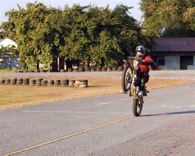

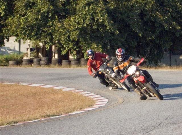

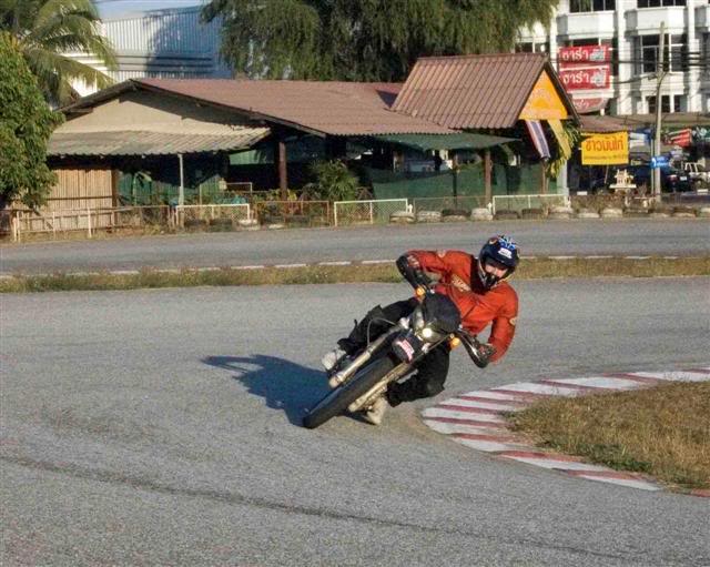

    Here's a couple of pics of AK47wildwacko/Hondahonky/SuzukiLuke proving just what you can do on an XR250 shoed with std wheels and road tyres from a chopper (note the ACU approved "racing plimsoles"!)
    Luke7LRSmall.
    Luke10LRSmall.
    At the time I had an XR400 with proper motard wheels e.t.c and he passed me with ease after a few laps of Chiang Mai Speedway. Then again, Luke is half my age and has bollocks twice the size of mine! ;-)
    JL8HRSmall.

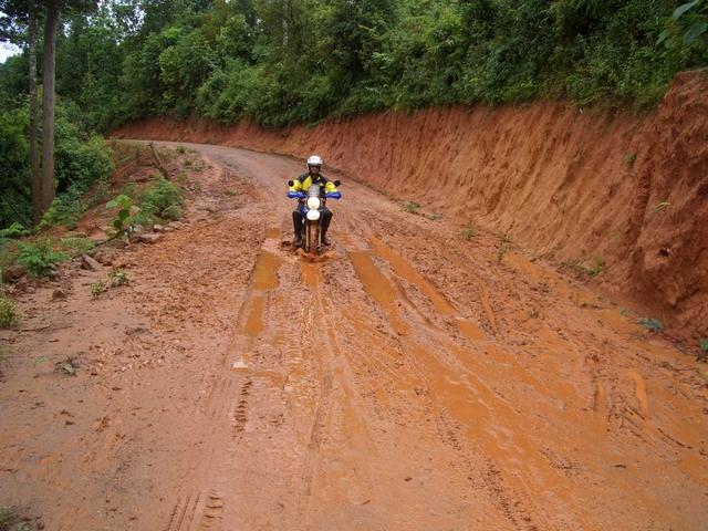

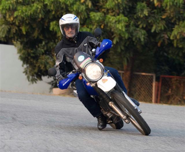

    I am always debating this topic with these guys. It depends on YOU the rider and what you really want to do. I have thousands of kilometers (not exagerating) on my DR250 and DR650 all over Thailand and Laos on DUAL PURPOSE tires.
    250trackb.
    This photo is on Dunlop 605's with 18 inch rear and 21 inch front, stock. The same track as Luke. I ride some pretty tough off road and also run with the best of them on the paved twisties. Many with larger cc and road tires cannot leave me behind on my dual purpose tires on BOTH bikes.
    I say save your money. If you are a VERY GOOD rider, and can use the full capacity of the tires to the point of them not being up to your skill, then change. Happy Feet, Big & Tall, Luke and a few others may fit this category (I am not). Most I would say cannot use the tires to their max anyway and there is not a saftey issue with a quality set of dual purpose tires on the road.
    Unless you are really riding at the limit, and are good, save the time and money and just ride the damn thing :lol:
