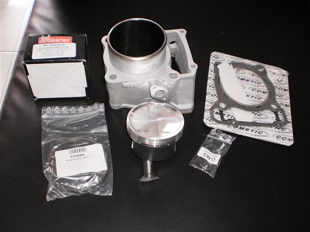

Firstly fitting a Kustom Kraft 331 big bore kit, the biggest expense ($750) & it was delivered to my shop USPS on my postman's motorbike, all I had to do was sign !! NO TAX....wow. Mark at Kustom Kraft put a $95 custom declaration next to the shipping address & they decided not to tax me. It took an afternoon (around 5 hours to fit) & went in great with a Woosner 83mm piston with Cometic gasket kit. I ramped up the fuel injection on the programmable APi ECU box by about 20% throughout the whole rev range very crudely on my laptop, so I could ride the bike away & run in the piston rings without running to lean & damaging the engine. It wasn't running very well but good enough to put 500km on the clock.....engine sounded great & low down torque was very good for the break-in period. A promising sign for the project.

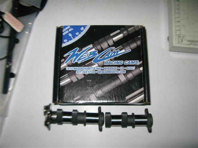

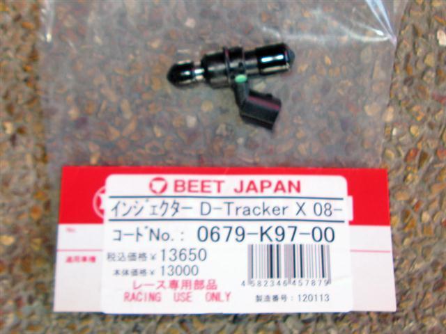

Next came the 101 grind Webcams (no tax again...wow....very lucky) & fitting the Beet higher volume injector from Webike Japan (1,200thb tax...damn) & while fitting these I decided to take out the secondary throttle butterfly, this was recommended by a guy call Jeffward on another forum as it's completely redundant in operation & can only restrict fuel & air flow in reality. The Cams & injector took about 3 hours to fit...easy....It's a real testament to how good Webcam's are, we we're expecting to have to buy some shims after fitting the Cams but all shims we're within tolerance by 1/1000th & good to go! 3/1000th would have been acceptably loose. My mechanic mainly fits hotcams & Scream'in eagle cams to Harley's & they never drop in like this. So we start her up & the idle is up to about 2400rpm (bigger volume injector at work), the louder noise from the exhaust which we haven't touched! has gone up by a decibel or two & the gases coming from the exhaust are noticeably delivering much more gas flow while standing behind the bike......my mechanic smiles & says "you gotta a bigga engine, you got lumpier Cams & you got more fuel exploding in there, which means bigger bangs = bigger noises....she's gonna fly!!". It took all my self-restraint to keep the bike under 6000rpm for 300kms to break-in the Cams, as the torque & extra power was very noticeable in my right hand! She was itching to be opened up!

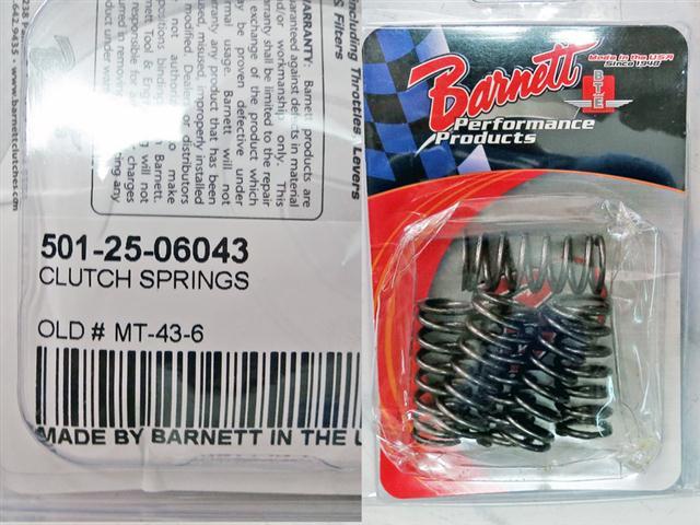

Just finished the 300km run-in for the cams & let her rip.......when the power comes in it really hits hard....so hard that the clutch started to slip when i was feathering in 2nd gear after giving the bike a big handful from the lights!! So with the front wheel lifting & the clutch slipping, I knew the power was GOOD!! just ordered some Barnett HD clutch springs.

These are the little heavy diuty springy things from Barnett. $20 on ebay (10 days to deliver from US with no tax) Part number for klx250sf: 501-25-06043. Now to stop this slipping clutch nonsense!!
