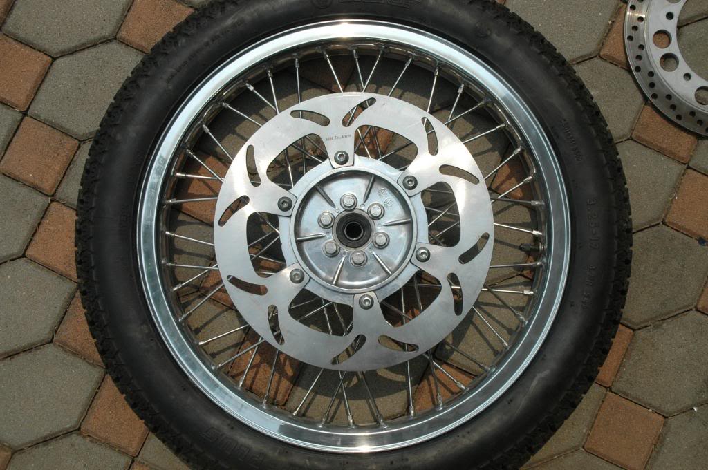

Mounted new Boranni aluminium rims with stainless spokes as part of the RE brake project. Went with 19" as I already bought the spokes so no improvement on the tire choices.
Brake rotor is from a Triumph Thunderbird and as I was not sure that it would fit, I cheaped out and did not buy a full floater. The rotor was only 90.00 USD so now that I know it works I will get a EBC floater. Note the rotor diameter compared to the stock rotor

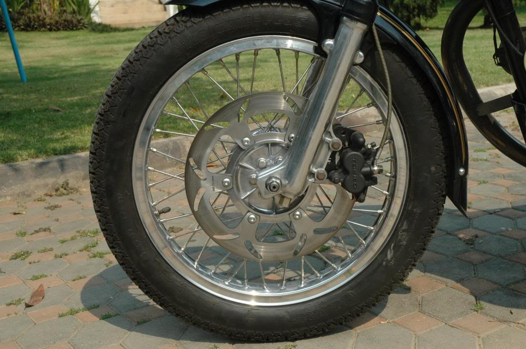

I wanted to have an opposed piston caliper but other than cheap Chinese, dinky, Brembo copies, I could not find one that would clear the spokes. I used a Tokio sliding caliper left over from my Kawi Versys radial brake conversion with EBC-HH compound pads.
The caliper is not a bolt on, and I had to TIG weld an extension to the sliding mount. Now that I know it all works, I will Tig up the stock holes and powdercoat the bracket to match the caliper. I did not like the look of the weenie stock bolts and drilled the fork leg to take a M10 x 1.25 mounting bolt.

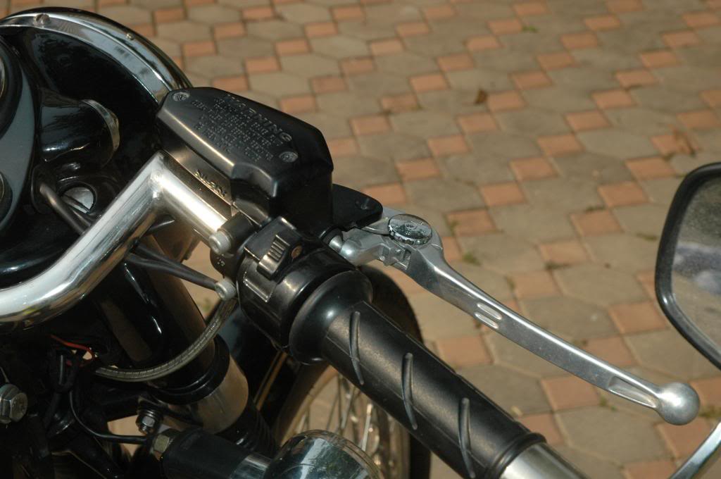

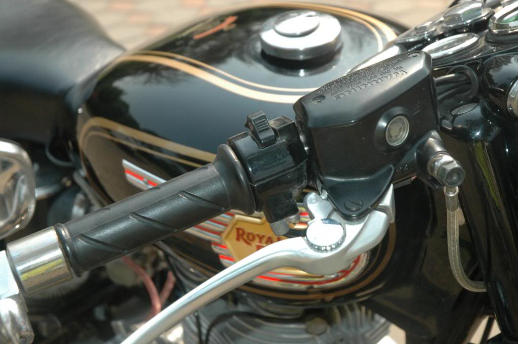

14mm master cylinder is left over from the Versys brake mod. I already had SS brake lines and it bolted right up.

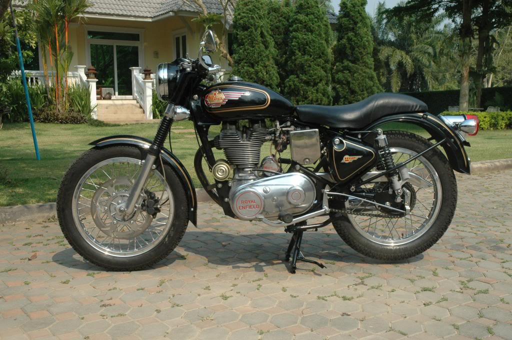

Mine is a 2000, Indian domestic, 535 Lightning, classic engined model. This engine was discontinued in 2008. Basically the same as the 1954 model and faithfully copied for 54 years.
Nothing of the ugly Lightning remains and it is a custom built 5 speed bike with several engine mods. It originally had a drum brake, but I had it built with a RE disc brake when Tim took us on our Rajistan tour several years ago. The RE brake was OK but could have been better, hence this mod.
