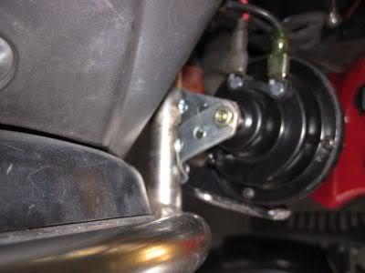

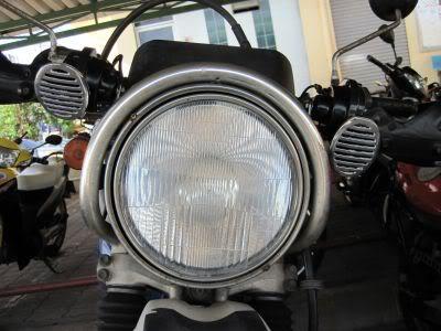

Horns - now on the dirt-bike:
Note: I've since rotated the horns to face down as it lessens the chance of water getting in and possibly ruining them.
Fastened:

I installed a pair on my F650GS today...they are loud...BUT NOT nearly as LOUD as those I put on my dirt-bike a few days ago!

I installed identical pairs of low-note horns on my Suzuki 250 Djebel and the F650GS.
The horns on the Suzuki are _very_ loud (best to wear ear plugs!), yet the same pair of low-note horns on the F650GS are much less loud.
The previous pair on my Suzuki were a low and a high note. They were loud, but nowhere as loud as those now on the Suzuki.
Go figure?

Jay, did you try to re-adjust them ? There's a small screw on the back (mostly 'Phillipps' ones) where you can adjust as usually they are made in China where final QC is not what we are used to. My Bosch horns had the same problem, just turning the screw a little in or out alters both the fullness and the level of the sound. Rgds, Franz
