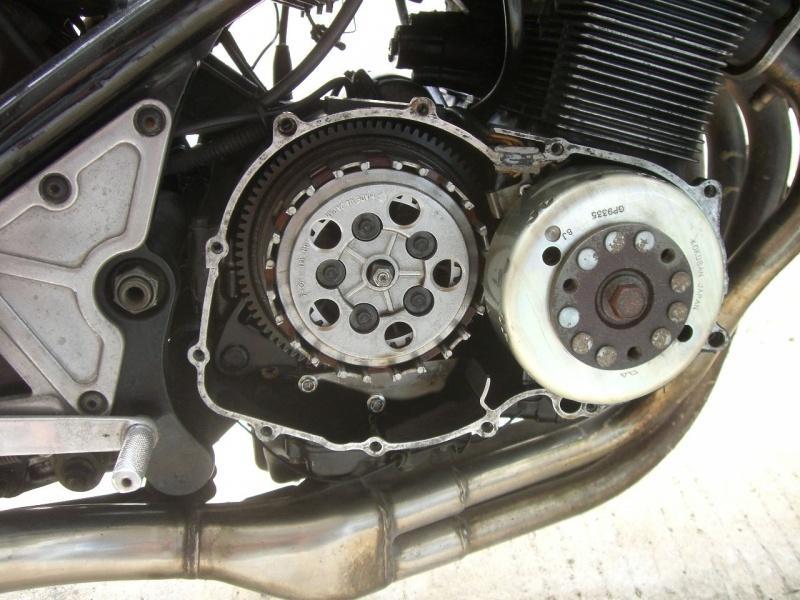

So finally, I decided to open the clutch.
At first glance, it looked ok....

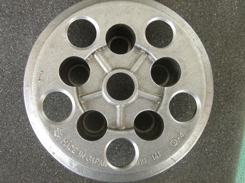

After removing the pressure plate (later identified as a plate from a GZ125 :crazy:),

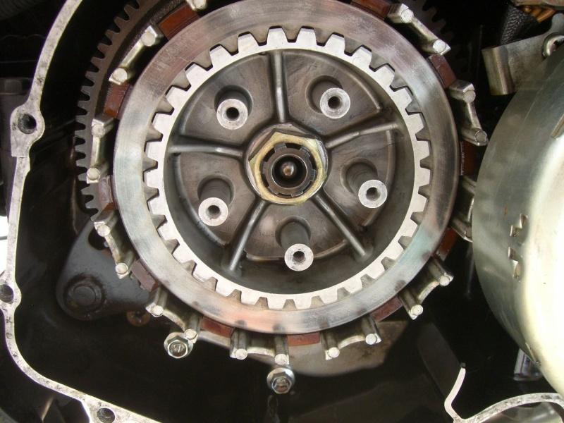

the first part that I saw, was a clutch driven plate and not the clutch drive plate.
Really, the first one was a steel plate....
I think, Somchai used it as some kind of "distance ring", because of the wrong size/thickness of the other plates...:huh:
Well, I took out the whole clutch packet, and found:
6 steel plates
and
6 friction(?) plates.
According to the parts manual, there should be
8 friction(?) plates
and
7 steel plates + two other parts (removed by Somchai, maybe to save weight?)
