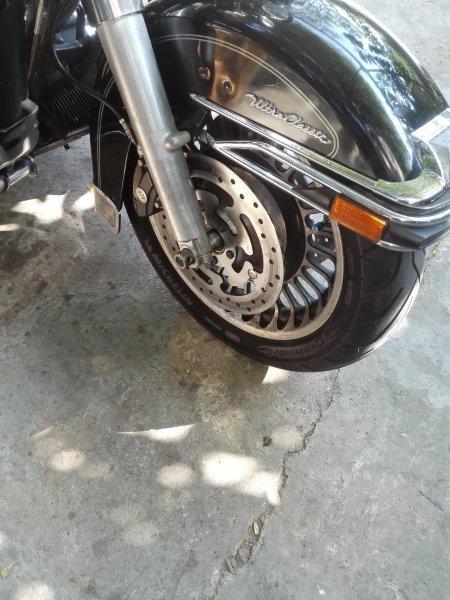

Hi Friends,
I wonder if you never heard about bented front brake disks, but it seems I have the issue on my HD Electra Glide Ultra Limited 2010...
Disks are slightly twisted and provoke jerkies when braking...
I would like to know if you ever encounter this issue, what could be the cause of it and how to fix it apart from changing the disks for new ones ???
Thanks in advance for your feedback.

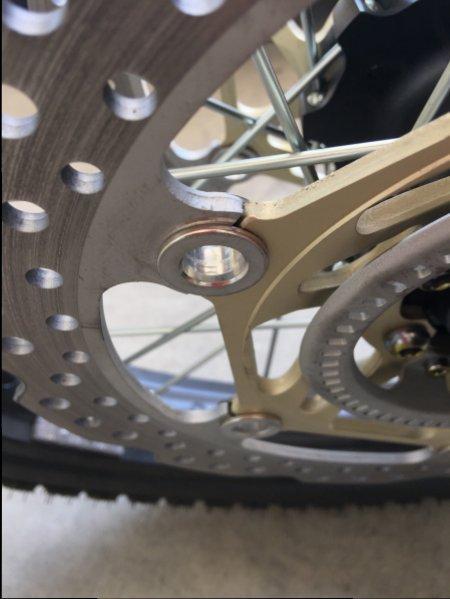

Are your discs, floating discs? If so, the rings that go around the disc could be ceased. You should be able to rotate them. If not, try freeing them up with a suitable brake cleaner and a nut and bolt through the holes to rotate them.

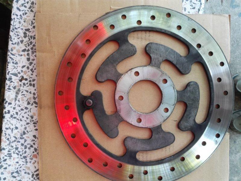

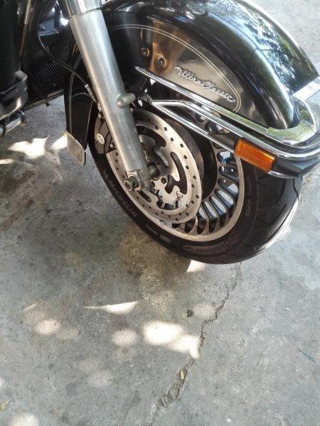

Hi Friends,
Hi Scotty007 & FaraGit,
Thanks for your reply and comments, in fact I achieved the change of my front brake disks, it cost me 8500 THB and one hour of work at my mechanic workshop who has all equipment and tools to do it.
It changes my life...everything is good again and I can conclude that it was the disks !
I still not understand how I could have dammaged themView attachment 3862
Now I recover the pleasure of driving safely and smoothly without any jerk.
Keep the Power OnView attachment 3862 View attachment 3863 View attachment 3862 View attachment 3863

No worries, it is sometimes possible to realign the disc using a rubber hammer in the right spot, but results are never 100% correct! Enjoy!
Hi Friends,
It's exactly what my mechanic did at the first attempt. He tried to correct them but when we refit the wheel, the test drive was not concluant. Thus I decided to change the discs for new ones.
Now it it's "Night and Day", it works perfect and I can stop the bike with no issue an ABS is working perfect as well. In some 50 years of riding, it' s the first time that happens to my bikes. Very strange and difficult to understand. Even on my Kawasaki 500 H, on which I had only one disk at the beginning (for a nice power) I did not had this issue....
