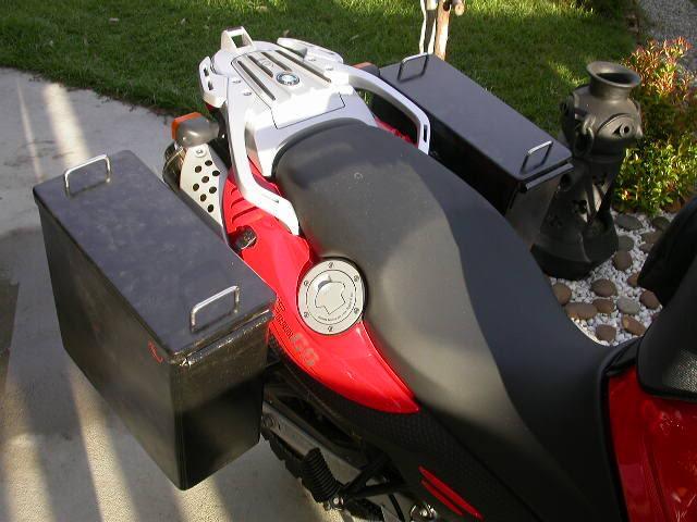

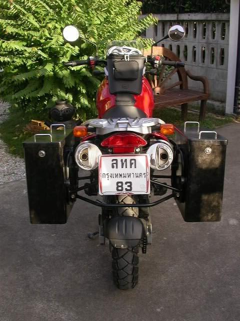

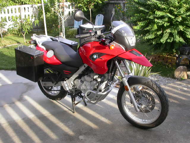

Hi all,
At least, I got them, thanks to a thai friend of mine who has a friend who works in Deng Glon Pratoo (DKT)...
They perfectly fit my F650GS (IMHO)... They are about 25 liters each: I don't think I'm going to do the "world around" :roll: They are sufficient for a "some-few-days" trip for 2 people...
Gross weight (brackets more paniers): about 12 kg.
Great work! It is exactly what I was expecting... Hat down masters!

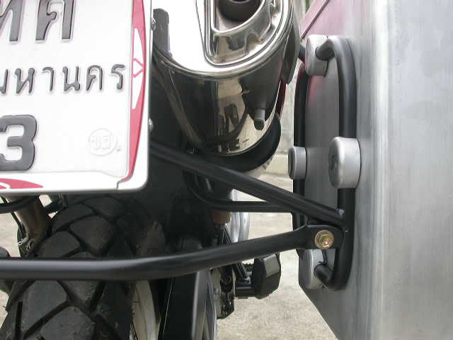

Brackets are made from a 16 x 1.5 tube of iron and then sprayed with a half-matt black... Screws and nuts have to be changed for stainless steel ones... I chose "fixed" paniers: my skilful wife is going to designed special bags to fit inside... We prefer...
"Cherry on the cake", paniers get a lock but no hinge: the cover (with a washer) is clamped with the box on the front side... Slide it in the clamp, close it down and lock it at the rear! Easier to take off bags and stuff...
Et voilà!
One happy biker more! :p
Really great work! Maybe not the "Oh dear, the german touch!" (who cares?), but for sure a superb piece of thai master-work! I "love" my paniers and thank very much the masters for their knowledge and thaeir skil!..
I chose a 3 mm gauge aluminium alloy (very strong paniers!)... If I had to "replay", maybe a 2.5 should be sufficient...
The next step will be a rear rack and a back-rest for the comfort of the pillion...
As said to me the workshop manager: cost of this work (same boxes with proper bike brackets), all included: 15000 Bahts.
Price up if bigger paniers or "very special option"...
Despite I like the "raw" alloy finish, paniers can be sprayed too (about 1000 Bahts more)...
Special design on request...
Phone number: 053-202269-70
Location: Going to the airport by the south highway (first ring), it is in the left hand soi just before taking the bridge, or the last soi about 300m before turning left in the Hang Dong road... The workshop is at the end of the long block left hand side...
Note please: ONLY THAI SPEAKING THERE (and very kind, pleasant and patient people)...
One more note: they can do a lot of "things" for your bikes (I'm amazed!)! Ask them what you want... and they will do it just for you!
Cheers to all!

Nice ones there matey,and not that costly.
I saw that you have covers sealed as well so they are water tight as well.
obviously you have picture from original banniers to show to them so they could imitate from there.
nice ones and looking forward to see your top box, that one, are you gonna make it removable?

Thanks for your comments Marco.
And thanks to correct me: the cover get a seal, not a washer!..
Yes, I gave the technicians some pictures, but I also drew quoted plans.
No rear top-box... I don't feel at ease with this; but just a rack in case of... and a back-rest indeed!
I'm now waiting for the specific F650GS BMW tank-bag I ordered 2 weeks ago in Barcelona CNX.
The idea is one panier for Madame and the other one for Monsieur, and just drop utilities in the tank bag...

Hi Richard,
Is the job completed yet? I remember there is the muffler on the right hand side of your bike... How do you manage with this?
If possible, some comments and pics would be appreciated...
Just for the fun (or only for mine maybe :roll: ). Some pics of "my" boxes at the end...
Thanks for part to BignTall, I decided to coat the boxes. But in a "not too black" finish painting slightly spreaded with a sponge...
I add too small handles on the covers, so in case of I can secure some light packs on them...
At the end it's exactly what I was expecting previously. And very useful...

Gobs - The bags look fantastic :lol: , more importantly I hope they give you years of functioning fun.
Good thing with paint is that if you ever decide to go back to the raw aluminumn look medium blasting is inexpensive over here. Another option if you get sick of touching up the paint from nicks and scratches is powdercoating. Its available in Chiangmai in two locations. I personally take my stuff to Richco motorsports off of the south side of the moat for powdercoating.

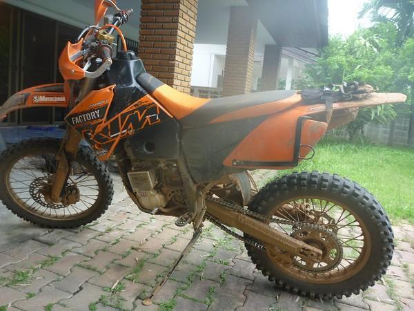

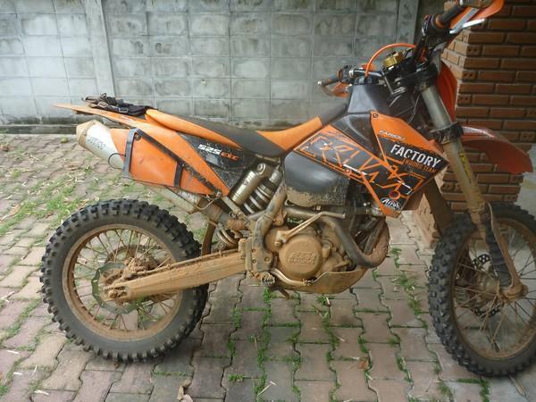

What a nice bike, your KTM, B&T! Wonderful... Wow, just the fork, man!..
I guess it's a X-cross bike and you use it in this way: so dirty! :wink:

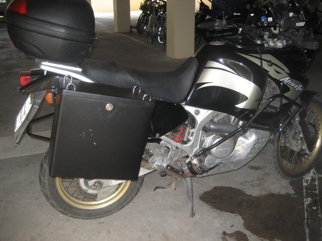

Hi all,
Just got the brackets and boxes on last night,so apologise for the crappy pics as I finished near dark then had to wizz down to ban pa mai near Lamphun.
The brackets come up great and powdercoated,I imported Touratech mounts so I can remove and fit boxes as required,took ages,3 weeks+ from Germany.(lucky tho,no import fee as they were delivered to my home address)
I attached some small brackets to the lids for ocky strap attachments also
Costing:
Boxes: 15k Bht,including brackets and painting in matte black and etch primer.
Touratech mountings: 3,600Bht the pair
Freight 1,450Bht = 5,050Bht
Richie Powdercoating (brackets) 2,500Bht
All up 22,550 Bht
A lot cheaper than genuine touratech at 60K Bht
I was able to leave the exhaust in the original position and mount the brackets outside of the can,which saved a few headaches !

Jun 5, 2008
Hi All
Firstly a big thanks to Dave E, for retrieving and posting my other pics for me,I think my com is really slow and something timed out.
Gobs,I used the same style lid attachment as yours,no hinge and removeable,but will probably attach a short chain from the lid to
the box in case it comes open whilst riding.
The Touratech mounts seem very good,but I needed 3mm spacers under the mounts as they are designed for 18mm tube and I used 20mm tubing,adding 1mm extra to allow for the powdercoating thickness and it worked out great.
I will "enjoy on happy trails" for sure :)
Ride Safe Everyone
Rich
