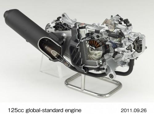

TOKYO, Japan, September 26, 2011 - Honda Motor Co., Ltd. has announced its development of an engine with enhanced durability, quietness, and fuel economy. The engine is developed for next-generation 125cc scooters; fuel economy is approximately 25% better than that of conventional engines for scooters with the same displacement.
Read more here: http://world.honda.com/news/2011/2110926Engine-125cc-Scooters/index.html

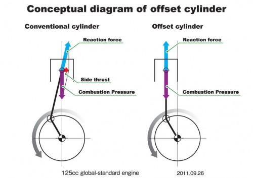

They show a whole list of improvements, personally I was most impressed by the offset cylinder that reduces friction between the piston and the cylinder.

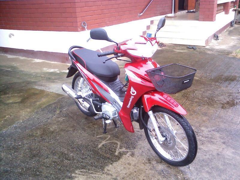

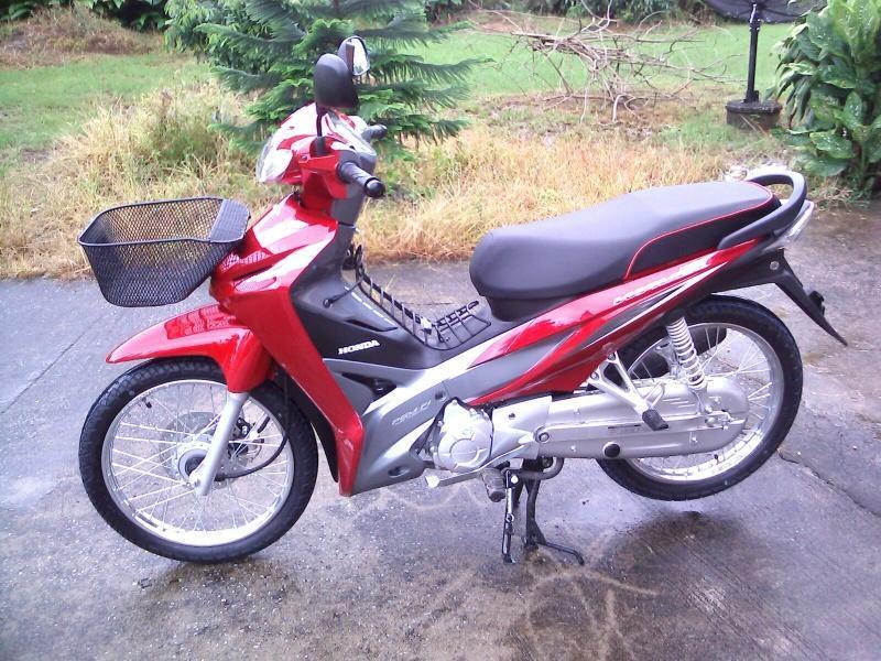

Have recently swapped a 4.5 year old 125 F.I. Honda Wave for the new model 110 F.I. Was concerned it would have less power - but not so. Pulls better up hills & runs very well indeed. Did some fuel consumption figures - best so far 203 mpg just knocking about & worst was 134 mpg running flat out to Fang & back. Overall average is 153 mpg & its done 3,400 kms so far. Good enough for me - if they can improve on that - well done to them. Apologies to those who speak in "new money" I'm old school & mpg means more to me than kpl.. New one also has a slightly wider rear tyre with a better tread pattern so offers better grip. Obviously totally different to my Bonneville T100 but a lot of fun can be had on a small scooter!

I wonder if this offset cylinder idea catches on and carries over to other models...

"Final fuel figures" - for the technocrats. Last 536 kms the wee beast has averaged 58.91 kpl or 166.3 mpg.. Over a total of 3425 kms its averaged 54.75 kpl or 154.6 mpg.. Good enough for the varied running its been doing. Carrying myself & Fon & sometimes a bag of pig food as well to the farm, towing a trailer of small piglets, flat out to Fang or ChiangRai, pulling all the way to DoiMaeSalong & back. It's had a good testing & I'm very happy with it. The 125 FI Wave was good, this 110FI Wave is better. Honda think they can improve on this & I'm sure they will, but this will do for me for the next 3 or 4 years. I've had enough of messing about with pen & paper at every fuel fill up. Might bother again in a year or two! I can understand how Capt. Slash & no doubt others have been all over Thailand on these scoots.. Fortunately I have the Bonnie for serious long distance touring (especially with Fon & luggage) but if I was on my own, a long trip on one of these would not faze me at all. The only drawback is the small fuel tank.
