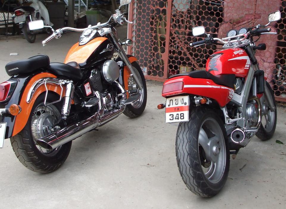

here some pics from a few years back when i had the bros & shadow...
mbox
Mbox999, why did you sell this nice looking NT650 ? Really good looking bike. Spares are no pompemm for me as I have 2 and will do 2=1. As for the sidecases, they're gone, will fit a topcase only as this still gives me enough storage for daily trip necessities. See you had the high handlebars installed, still considering if I should do the same but find the current and original short and low ones not too uncomfortable. Cheers, Franz
Franz wrote: Mbox999, why did you sell this nice looking NT650 ? Really good looking bike. Spares are no pompemm for me as I have 2 and will do 2=1. As for the sidecases, they're gone, will fit a topcase only as this still gives me enough storage for daily trip necessities. See you had the high handlebars installed, still considering if I should do the same but find the current and original short and low ones not too uncomfortable. Cheers, Franz
Honestly, the bros looks great...but lacks comfort, but besides that i was having eyes for something else then...so both bikes had to go and than i had a Honda vfr 750 K than a vfr 750 FG and finally a vmax 1200 ( and a freaking wife :) )

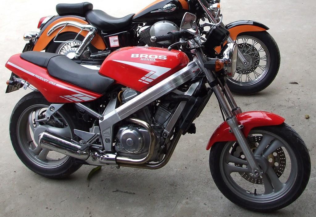

Some fotos in restored condition:
Strange, but this bike in yellow looks really cool.
Have seen one in orange, also nice colour for her.
Any attempts for me to fit topcase or sidecases didn't work out favourably in the overall layout of the bike, looked fugly at best.
So good luck with yours !! Get yourself a good repair manual and try to Photoshop some fotos in different colours so you can get an idea as to what colour suits yours best. Cheers, Franz
