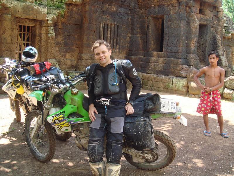

I've done over 20,000 KM's on my KLX through Thailand, Laos and Cambodia. Its a small displacement single so you wont be covering the boring slabs as well as a big bike but it can be done. Key modification is to have the rear of the seat widened by about 3 inches. This is easily done over here for under 500 baht at most scooter seat places that litter our cities. The extra width provides andded surface area to cushion the pressure poinjt of your arse on the seat and making the ride that much more tolerable.
Choice of tires will also help you deal with the boring slab duties. A non knobbie like tire like the one i have here:
helps smooth the vibes of the single on the asphalt.

Just what are the non-knobby tires you've got there? They look about right to me.

The ones in the picture look like Bridgestone Trailwings to me.

They look like the older Dunlop D604's that I've on my Suzuki 250, although they may be the newer D607's which have the same tread design. I've gotten good wear with the 604's and they've been okay for the limited times I've taken them off-road.
Sorry not checked back on the web site in awhile. The tire in the above picture is a Bridgestone Trailwing from a few years ago. I traded in Knobbies for a long pavement section I had on the way to Cambodia. The Trailwings were a lot smoother on pavement than the normal knobbies I run and were decent on the hardpack dirt, and rocks up to Bokor Mountain. The don't do as well in the slop where their grip is compromised due to the lack of tall knobs

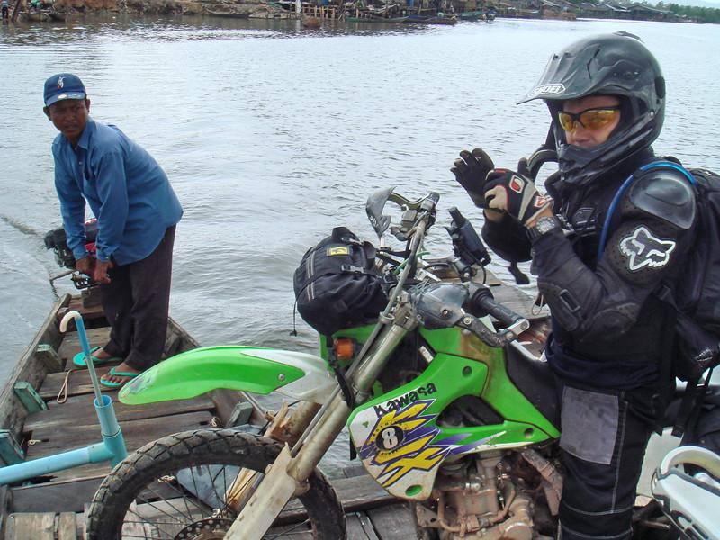

A good compromise for pavement and dirt is the D605 by Dunlop pictured here:
Long wearing and more grip than the Trail wings off road and smoother on road than Knobbies. I think the new version is called the D606.
