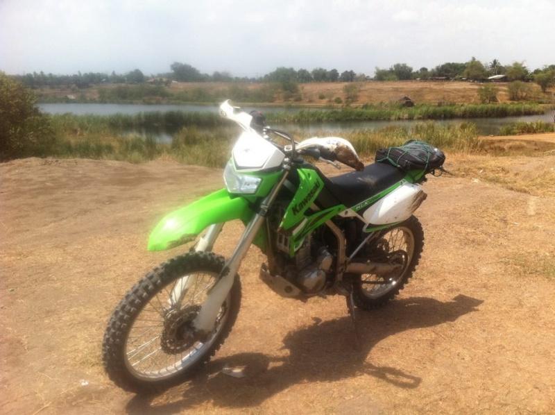

Here's a fantastic bike for sale.
KLX350S has been fitted with the Bill Blue 350cc Big Bore kit. Fuel injection system has been removed and carburetor fitted. This is well over $1,000 worth of modifications.
This bike goes like a rocket. The bottom end torque from this bike is unbelievable compared to the stocker, 2nd and 3rd gear power wheelies no problem.
Has been fitted with aftermarket skid plate.
Tail Tidy.
Pro Circuit Ti4 slip-on with cherry bomb/header pipe
Only 6,000Km on the clock.
I have just serviced this bike myself and is in great condition.
All original parts are included to return to stock if required (Why would you want to do that!)
All paperwork/green book in order for immediate transfer (registered in Chiang Mai Province). Thai Vehicle Transfer docs signed and ready for transfer.
Easily the best modified KLX in Thailand...
130,000 Baht ovno (Comes with a free WR450F!)
