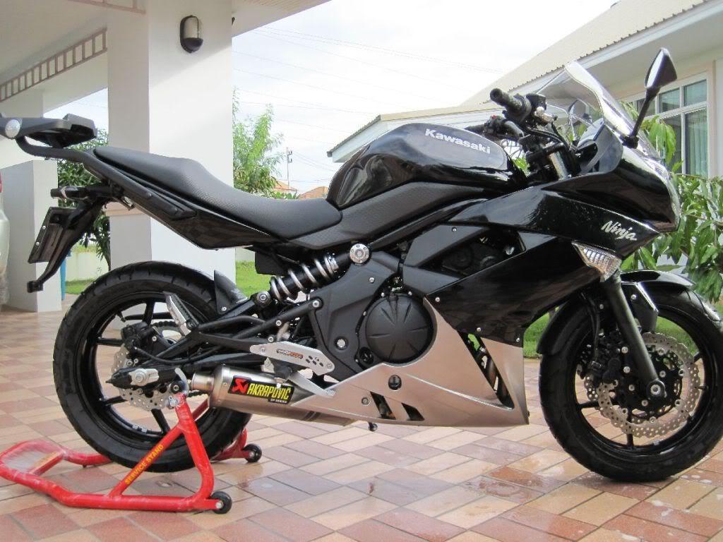

Well the little girl is part of the family now and has deserved a couple of treats so a few pics to bring things up to date.

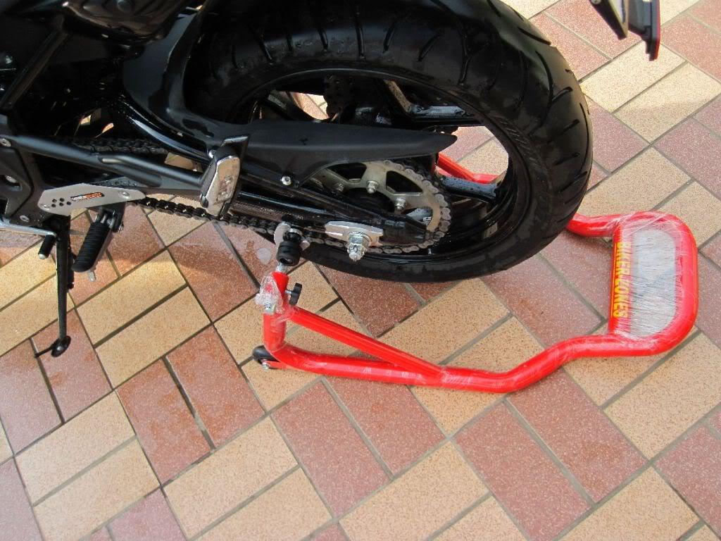

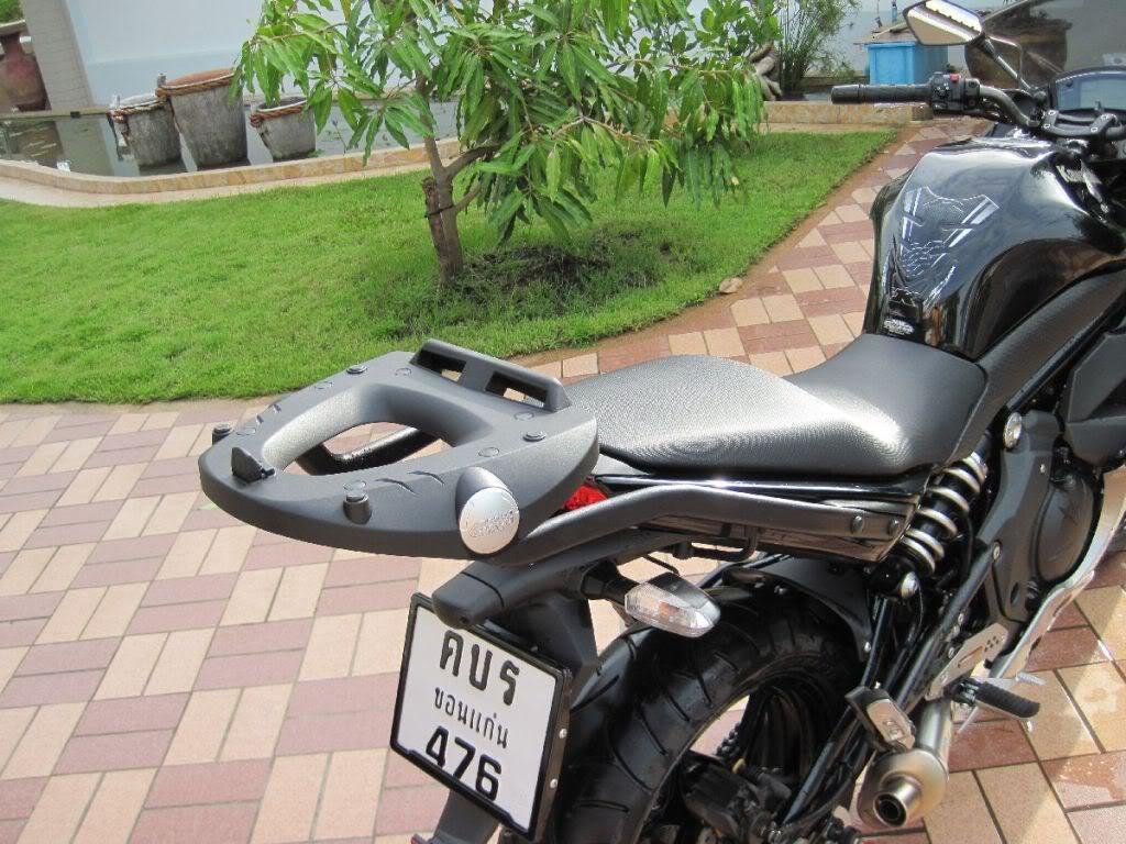

Fitted Givi Rack, Cost 9,000 Baht. Akrapovic exhaust 23,500 Baht, and showing paddock stand 1,900 Baht. All from Kawasaki Udon.
Rack Stand and exhaust

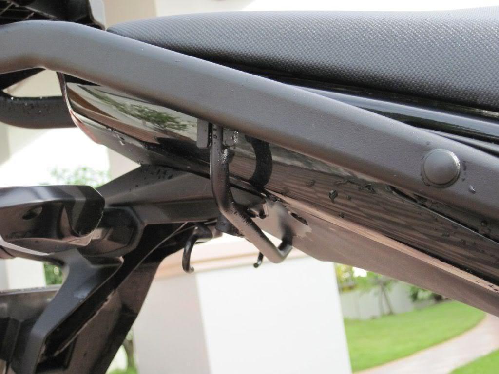

Previously someone commented that the rack looked a long way back from the support, which are from the removed grabrails.. However Givi provide a bar which goes under the seat and is bolted thro, providing support further back, The rack is very solid and will support well over the claimed 10kg. It also follows the form of the bike and looks good. An extra bonus is that it is that the support arm is a great holding place when manouvering the bike around the garage etc. The original grab rail was flimsy and not so far back.
Closer up. The rack is made in Givi Italy factory. The part numbers are 449 FZ arms. Then M5 plate for Monokey systems, the heavier boxes, or as I have fitted the M5M plate for the Monolock systems which are available within Thailand via the Givi Asia Malasian factory, and local sales outlets.

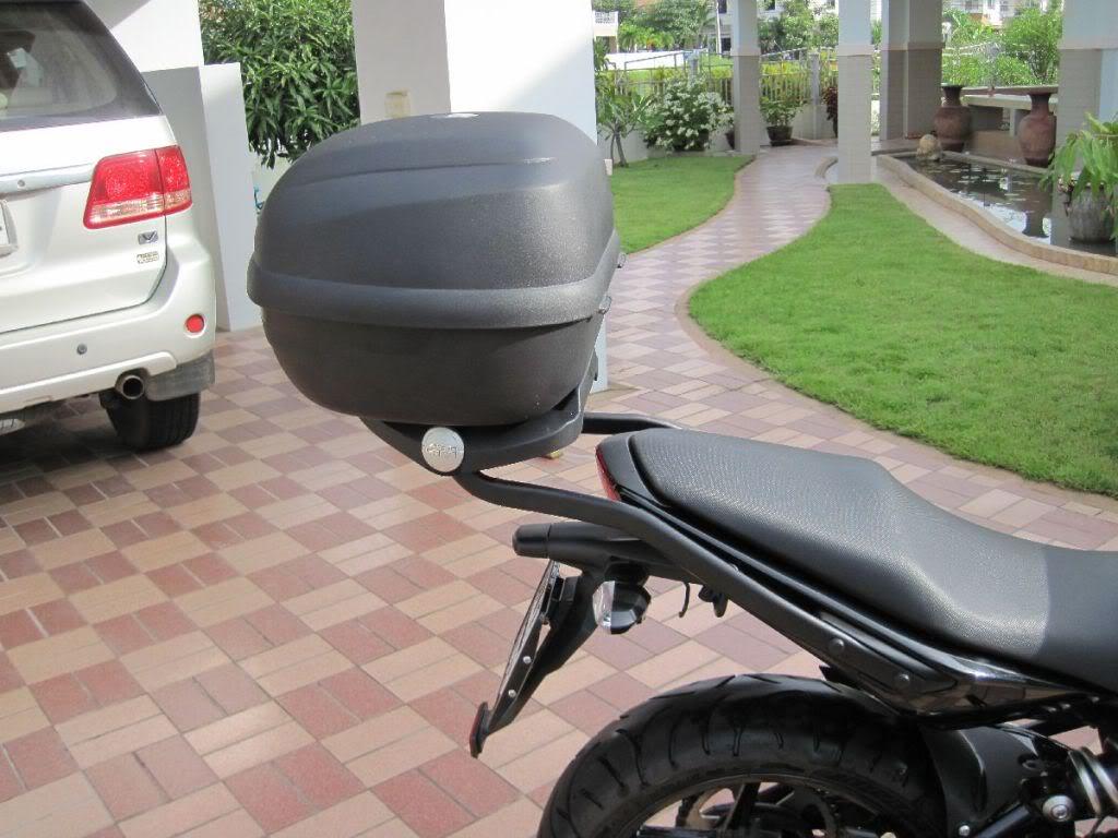

I bought in KK a 33L Givi Point Monolock box. This was only 3000 Baht. Its stated load is 3kg. I only intend to use this locally, longer journeys will use Tank Bag and Tail pack on the seat and rack.
The box is well made but much lighter than the Monokey boxes. The box is not a copy, it is made by Givi, but for lighter duty with thinner plastics.
I have ordered a rack for the FZ1 also and will use the same principle, box for local duty, tank bag and tail bag for longer trips.

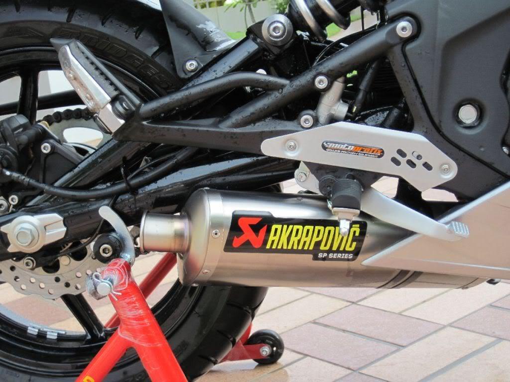

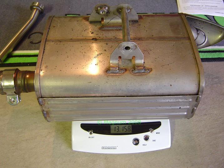

The Akrapovic exhaust is a direct slip on replacement. It has a port for the O2 sensor so will run acceptably without other mods. It is a tight fit, but it goes in without fouling anything.
It is about a quarter of the weight of the original. The bike does not sound like a lawnmower any more, but I have not yet removed the baffle to get the real sound. I do not use my exhaust as a safety aid, frightening all in my path.

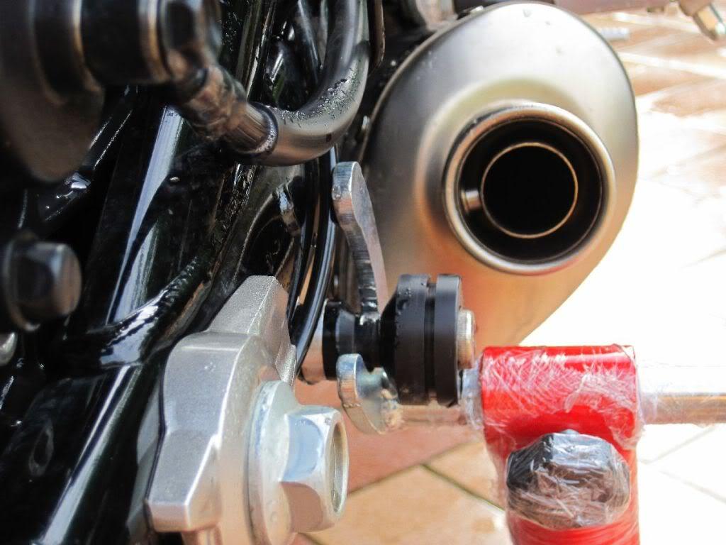

The outlet does impinge directly on the rear slider that I fitted to give a support point for the paddock stand. The plastic parts in line melted within minutes. Two other vunerable things are in the region. The ABS sensor cable and the brake line. They however are far enough out of the firing line to not be affected.

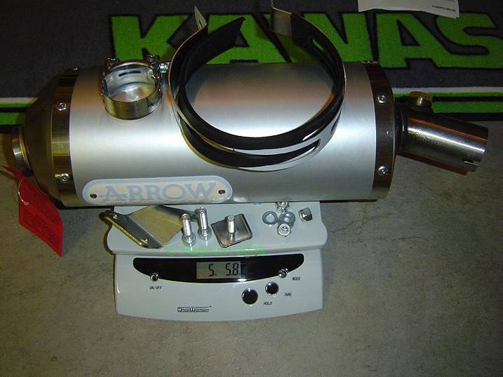

Looking Good John 8) Love the Exhaust really Looks Good and a Big improvement on Original! A Guy here has fitted the ARROW Exhaust to His which looks very Similar and He claims made a Noticeable Improvement to Performance and of Course the Sound!!! :wink: See You soon I hope.

The Akrapovich makes a really nice sound and apologies for melting your slider John.
