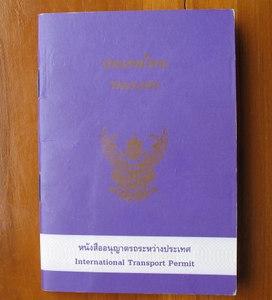

Following "Ozzyboy" input I wish to correct a detail about the "International Transport Permit". You wrote "they only issue these at provinces near borders I was told"... This is not true, mate.
The simplest way to get it is to contact the "Land and Transport Office" where one goes to pay the annual vehicle tax. It is linked with one's official address in Thailand. Mine being in Bangkok, Ratchatewi district, I had to go to the Chatuchak Land & Transport Office. Cost = 60 Bahts. It's valid for one year. Easy to renew when the vehicle tax is due.
I felt to add this minor info to display some optimism about the "Friendship Bridge" issue. Keep the optimism on... And throw away personnal prejudices... Following "bkk teacher room number 6 story" some general prejudices have surfaced on this site. Against teachers, against Yamaha riders...I don't mean to add some flames but it's a bit disappointing...

Yes . it's fuuny how information is not always given clearly, I mentioned the 'it's only issued at border provinces', as I tried to renew mine here in Sakon Nakhon, before I took my bike to Chiang Mai to sell, so the future new owner would have it, but they told me they don't issue them here, and I had to go to a border province, however Nakom Pranom would issue them as they have a Ferry crossing the Mekong there, about 90k's from here.
Sorry about the oversize pix, I am not sure how to get them smaller, as I had again a fair bit of trouble getting them on here, and I had thought they were all the same size. Comps' are a hassle at times.

Thanks for the tip re the International Transport Permit.
This "vehicle passport" has been previously mentioned in a post by BobS at
http://board.gt-rider.com/topic.asp?TOP ... hTerms=gps
Re the ITP being the key to getting into Laos at the Friendship Bridge I don’t think so, as I specifically asked about this at the MoT & the answer was NO.
