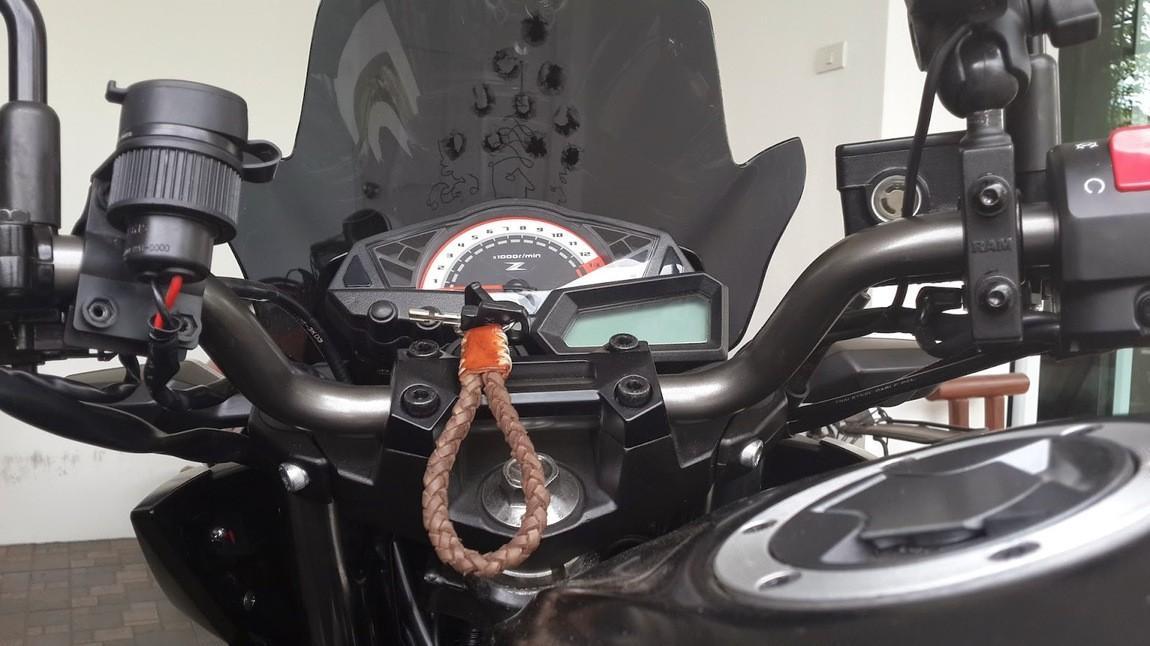

Here the ER6N handle-bar on my Z250. Still have to figure out a better way to install the 12v-outlet.

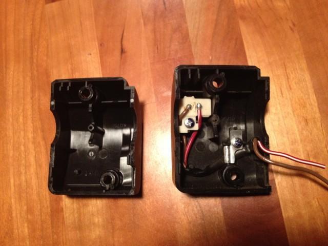

OK I did open the signal-switch and indeed the hazard-switch is just removed and could easily be put back. I would be to no surprise to me if I have to buy an all signal-box for that (so anyone has a damaged one from the hazard-switch can be removed?)
And the wire at the signal-switch are indeed 1 from the flasher-relay, 1 to the left-signals and 1 to the right signals. So would be easy to test. I did switched the right signal-lights on and used a small wire to connect to the wire of the left signal-lights. Now all 4 signal lights should be working .... but that did not happen. Probably as the flasher-relay is not build for this purpose. I did read somewhere already that people replace the stock flasher-relay for another one. Next problem ....
