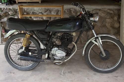

Well it arrived this morning. I have been thinking for a long time about doing a custom bike. In high school I always wanted to do a custom car but never had the funds to do it properly. Now I could not care less about cars, preferring motorcycles. So I am about to embark on a journey of doing a complete custom bike. I thought I would start small and with a number of old CB 125 junkers around, and cheap parts in plentiful abundance, I thought I would start on something of a cafe racer town bike, just for fun.
I found a shop that could get a CB 125 for me and ordered one last week. Unfortunately it arrived and was not a CB 125 like I had ordered but a Wing 100. Pretty much the same bike, just not quite as nice. From what I can tell, it shares pretty much the same frame so I should be able to do most of the work and if I like the result, swap out engines later without too much hassle.
I hope to post some photos and progress reports as I go. But what I am really looking for is advice from anyone who has ever undertaken a project like this. What I hope to end up with is a small displacement cafe racer for under 30,000 baht (hopefully a lot under).
I have some ideas in my head already about what I want the bike to look like when I am done. This one is pretty close to what I had in mind. Though I would like a custom tank and a little more sporty colour scheme.

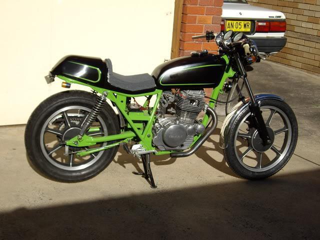

Lotuseater - don't know if I am helping here, or sending you on a wild goose chase... Here in Australia, when I wanted to redo the frame on my XR250, it was $Au100 (about 2500 baht) to have the frame bead blasted to remove all paint, and then another $Au40 (about 1000 THB) to have it powdercoated in the colour of my choice... since that is almost entirely labour costs, and minimum wage here is about $Au20/hour (about 4700THB/Day) I think you should be able to get it done pretty cheaply... for a few hundred baht... I know from stripping cars to do it with power tools is many many hours of work...

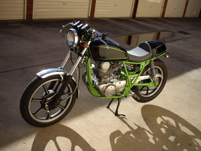

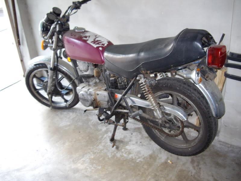

Have a look at a mates bike that he picked up when someone was dumping it, and restored/customised it here...
download.php
simillar style of bike to yours, but 25 years old... might be good for ideas...

daewoo wrote: [quote quote=lotuseater]Does anyone know a good way to strip a frame. I have been reading around and a lot of people seem to have the opinion that a wire wheel will do a good job of getting rust and paint off the frame.
download.php
Daewoo

Marco wrote:
When i tryed to view your attachement got this= You are not authorised to download this attachment.
That must be why you it comes up as an address rather than an image in the post...
I uploaded it to PhotoBucket just for you Marco...
Daewoo

Daewoo, thats a nice bike thanks for sharing some ideas. I really like the look of the bike, what model was it originally?
It is a 1982 Kawasaki Z 250...
This is what it looked like when he found it. It had been put out on the side of the street for the council to take to the dump...
Pretty good improvement for almost no money if you ask me...

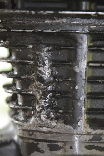

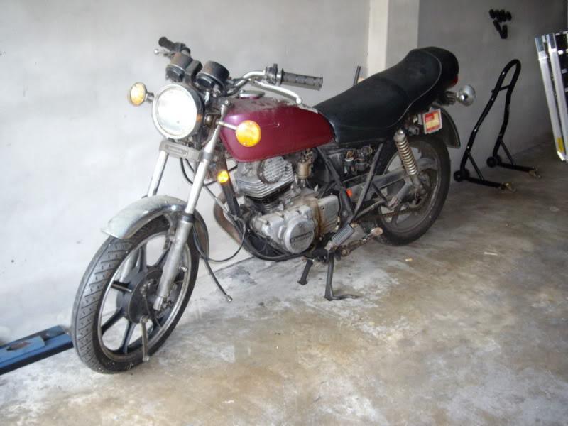

Well after a couple of mornings of wrenching away some progress has been made on the bike. Some little things are starting to show up that are going to cause problems later on if they don't get fixed now. Many of the screws and bolts have been badly striped and are going to need to be replaced. I am not going to be doing any engine work myself this time around, I don't have the tools needed and I don't want to be mucking around inside the engine too much. It runs pretty well so it won't need much but some polish and paint. The tank, seat and most of the other parts are going to be tossed. The frame is in really good shape and won't need much work but a cleaning and paint. I am still debating whether or not I should grind off the airbox and battery tabs, I am going to grind off the rear sets though.
The bike before I got my greasy little hands on it. It was running, though badly in need of some tlc. The brakes barely worked and it had a tendency to stall when idling which almost caused an accident on my way home with it.
A couple of hours of work and the engine is out and the frame is mostly ready to start sanding and grinding in preparation for paint. The fork is still on the bike because I don't have a socket big enough to get the mounting bolt out but I hope to have the frame completely ready for sanding by the weekend.
One thing that has me very worried is a weld that runs down the side of the cooling fins. I didn't notice this when I picked up the bike because it was partly hidden but I have been assured that to get a new case would be less than 1000 baht.

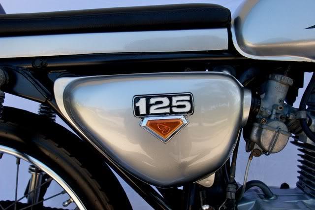

If You need some more inspiration for your CAFE racer project these pictures of factory built small cc retro bikes will help you.
The first one is the Honda Dream 50 which came on the market early 2000. The bike was a copy of the Honda CR110 50 cc racing bike but had a restricted engine so that it can be sold to Japanese school boys. Anyhow the bike was “foundâ€

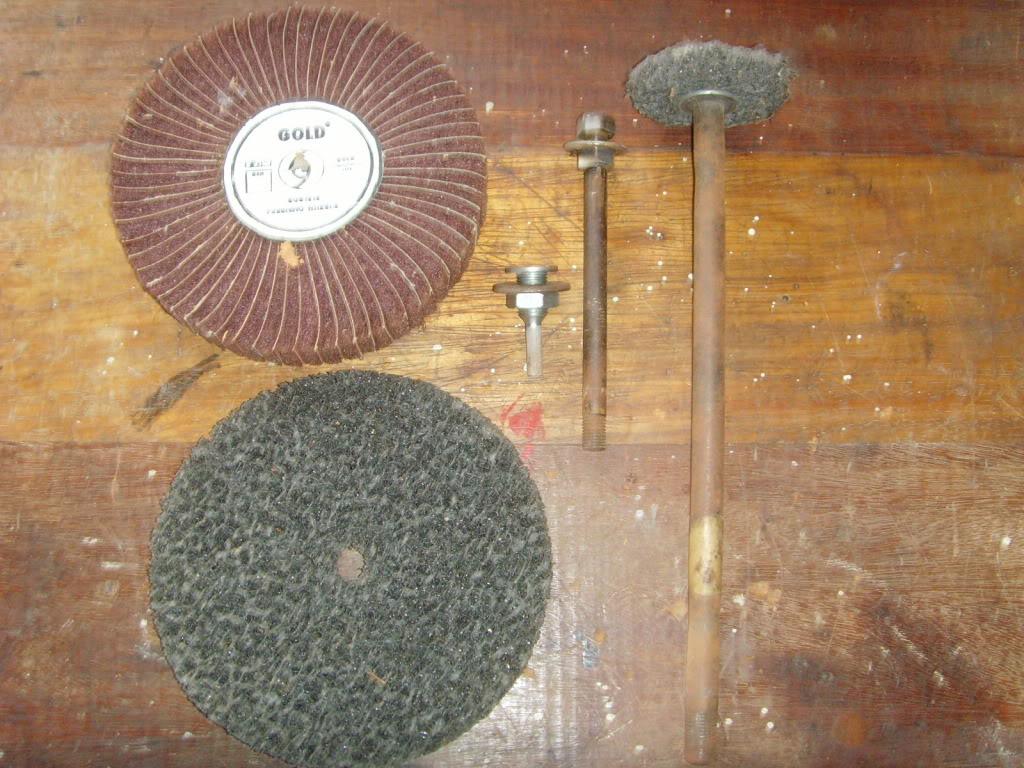

Sitting down and going through some of the parts I am going to need for this bike was a bit of a wake up call. It is going to need many new parts and that is going to bring me closer and closer to the budget that I had set for myself. It is not that big of a deal if I go over but I don't want to be too much over because of the type of the bike that this is and it is the idea behind this bike that it is cheap and fun.
So far as I can tell, I will most likely need a new fork. I wasn't to put disc brakes on the front of the bike and the current fork has no mounting tabs. I will also need a new hub to accommodate the disc break. The whole wheel is not in very good shape so depending on price I may just scrap the whole thing and get a decent new front wheel. The back wheel is not in much better shape, I will have to see what it will cost to chrome the wheel but I imagine by the time that all is said and done it is going to be cheaper to just buy a new one. The rubber is also in pretty bad shape and I am going to need some new tires for the bike. The bike will need a custom seat and gas tank and that is going to be a bit pricey. I also want to put a custom set of clubman bars on the bike. There are not a lot of original parts on this bike that I am going to keep. Thankfully parts for this type of bike tend to be very plentiful and cheap.
With this in mind, I decided to forgo the professional powder coat. I started stripping the frame this week and it should be ready for a coat of paint by the weekend. I have been using a drill and wire wheels and have found out that this is not a job for the faint of heart. It is hard, hot, dirty work and it is taking a long time.
I have found that it is also very hard to get the frame down to bare metal. There is a lot of surface rust and pitting on the frame that was hidden under the original powder coat. I am starting to wish I had just taken the frame to a place with a pressure washer and gotten the dirt and grime blasted off instead of dealing with the rust under the paint. It is slowly coming along though.
