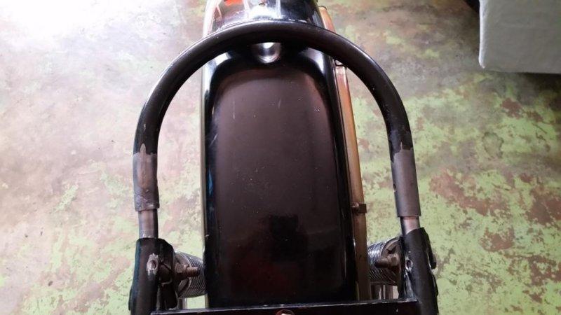

I had had a bit of an issue with the '71 Morgo Triumph 750 Tiger. The rear frame loop was cracked on one side for a few years and then finally broke right off.

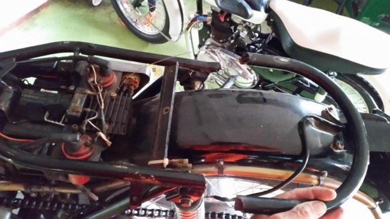

I had in the past attempted welding the first broken side with external weld, but that does not work. The "oil-in-frame" Meriden Triumphs often had this frame failure at this location. The Reynolds frame is a good rigid frame for a it's day, but this is a known weak point. I believe it's due to the loop carrying the full weight of a passenger and the fact that the rear shock mounts are welded to the frame at the front of the loop. Many people with custom bikes or who only ride solo, just cut this loop off and ride it like that with a different seat. But I did want to keep a full length seat in order to strap a bag on the back.
After online research and talking to engineers, the only real way to fix this failure is to weld plugs into the frame tubes. So, I turned some solid mild steel plugs on a lathe, to fit snugly inside the tubes. Heated and bent them to shape (a bit tricky trying to get 2 lengths bent identically). Before fitting the plugs I drilled the frame tubes about an inch away from the break, 2 opposed holes on each side of each break. Then with the plugs tapped into position and the mudguard fitted to ensure correct positioning, welded the plugs onto the tubes at the break and on the holes. This worked out well and all is now strong.

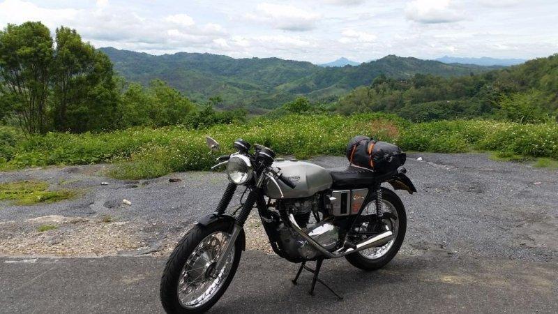

Some old mates were coming up from Pattaya to Nan, so thought I'd have a blast down there for dinner and test the repair. I had also re-wired the bike recently so needed to test all that.
The 1148 down to Nan seemed like an ideal route to test the a sporting bike.

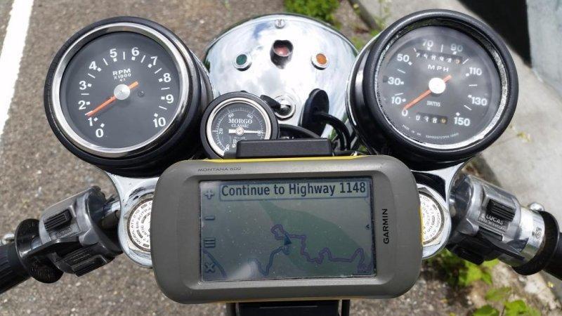

Constant 80psi oil pressure at the big ends, thanks to the Morgo rotary oil pump which at least doubles the oil flow over the standard plunger pump...... great to have an oil pressure gauge too, to give you confidence.
The bike was occasionally misfiring for the last hour of the ride into Nan. Initially, I thought water in the fuel, but draining the float bowl of the carb showed none. After arriving at the hotel, I check plugs and points and all seemed good. Still have the original Lucas mechanical contact breaker on this bike and it works fine, haven't adjusted it for years. Then luckily noticed the spade terminal of the low tension wire on the drive side coil was loose. Squeezed the female connector tighter and fault fixed.

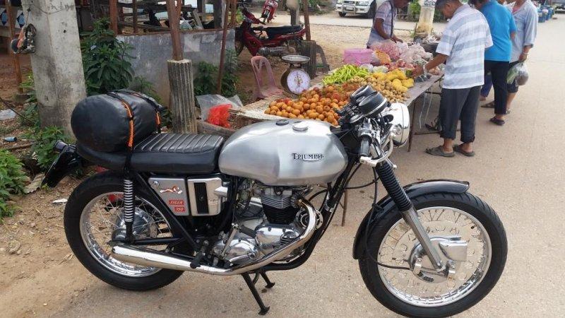

2 days, about 400 miles. Pure joy, on a wonderful old machine, in a fantastic country.
