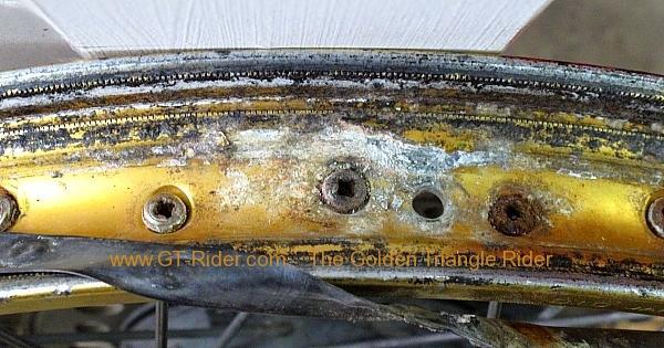

It did strike me as a bit odd though, a flat front & basically a new tyre. So when I chugged into the Castrol Biked Point 500 metres up the road, I was a bit surprised to find nothing in the tyre to indicate a puncture from a nail, piece of steel or glass.

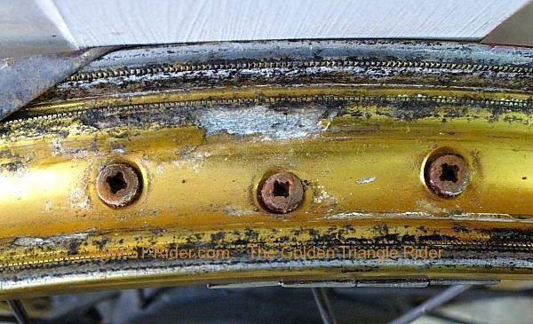

After taking out the tube & inspecting the tyre we were a little surprised to see the puncture was on the inside of the tube & not the outside.

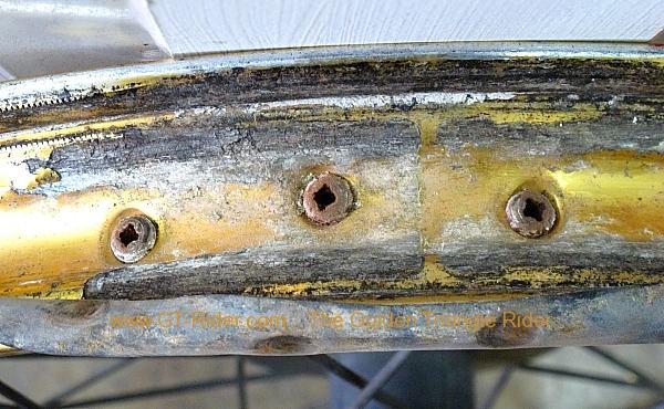

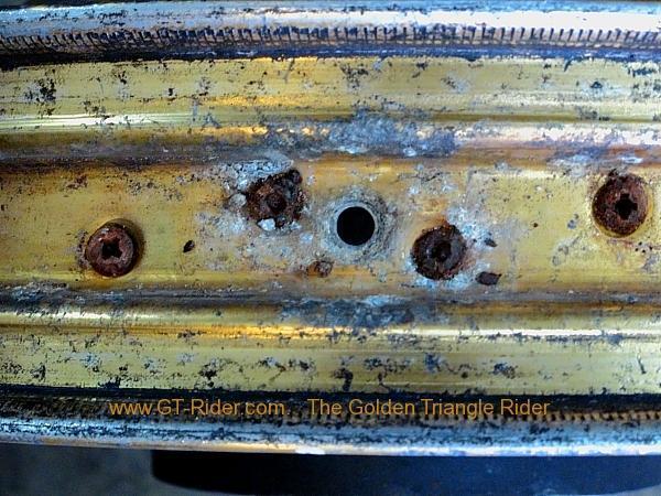

However after a close inspection of the front wheel rim it was no surprise.
In fact I was somewhat shocked at the state of the inner front wheel rim. :shock:
but then I thought a 95 model bike with 268,000 kms on the clock. :?: :idea:
Perhaps this is something that I should have paid attention to a long time ago. :?:
I had never picked up this before because whenever tyres have been changed the bike goes into the Bridgestone car tyre shop, they change tyres in 20 minutes & pop the wheels back on. I never look or checked. :roll:
So the moral of the story - if you've got an older bike with high kms pay attention to your wheel rims. :thumbup:

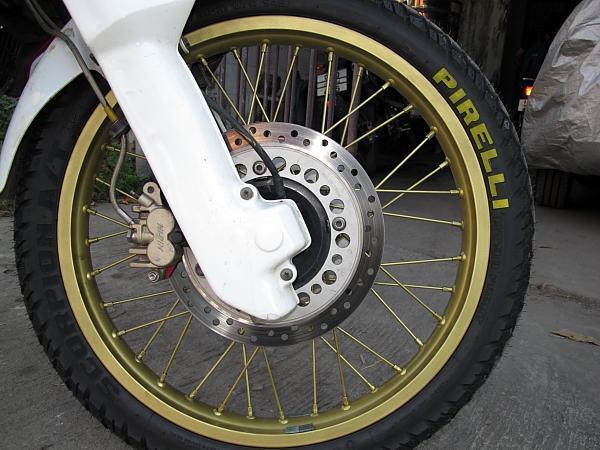

FRONT: 21 Inch. 90/90 21 inch tyre.
REAR: 17 Inch. 130/90 - 17 inch tyre.
