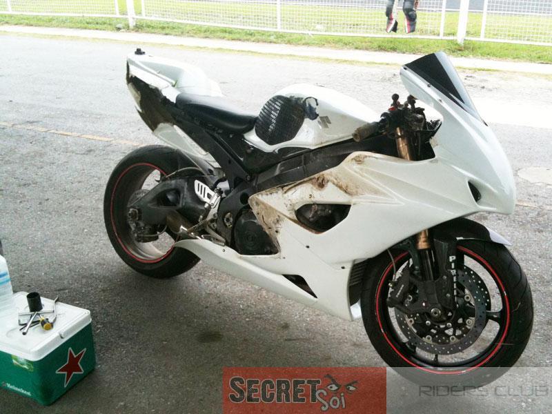

Good fun at the BRC today- a ton of bikes out on account of the holiday. Things were going great and I was getting comfortable and pushing the pace, then I crashed... :oops:
Grabbed too much brake at the end of the straight and the front end went out from under me. I dunno... I brake way harder at the end of the straight at BIRA and have never managed to lock up the front wheel there- the surface at the BRC must be a bit slippery compared to BIRA...

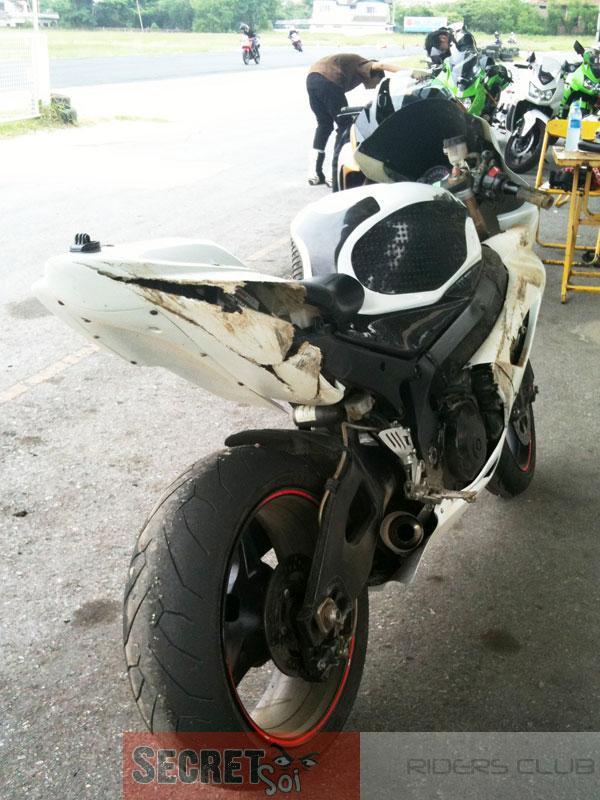

Track fairings are pretty knackered but hopefully they can be patched up.
Snapped off my Pazzo brake lever, slider, swingarm spool, mangled the throttle grip, bent the right re****t and a nice dent in the tank, shouldn't be hard to fix.
Thank goodness I was wearing full gear- I slid a good 30-40 meters down the pavement before ending up in the dirt. Bruised hip is my only complaint, but man did my suit and gloves and boots get rashed up. There were a lot of fellows out riding in jeans and sneakers- I hate to think what would happen if one of them goes down...

Tomorrow I start sourcing parts and find out if the fairings can be repaired. I was way overdue for a crash- glad it happened on the track.

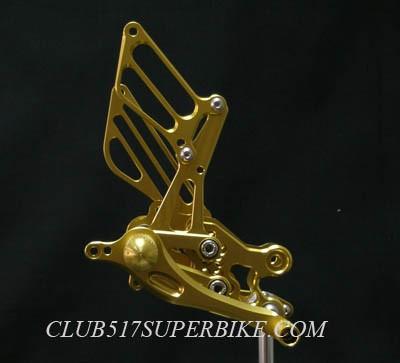

Ordered new race re****ts from Moth Racing today but alas they won't be ready until after Songkran.

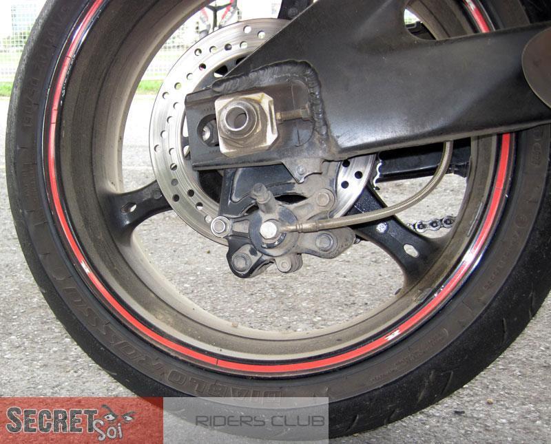

I managed to snap off the bracket that holds the RH Swingarm spool...
Bit bummed about that- hopefully I can find a shop that can weld a new bracket on- doesn't have to be pretty, but has to be strong enough to support the weight of the bike.

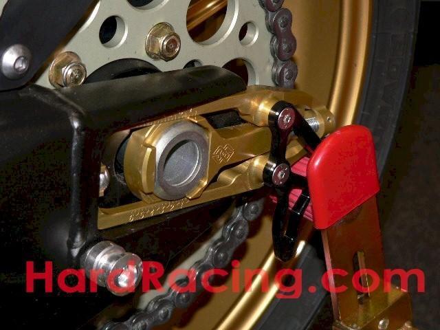

I was tempted to get some of these Gilles Tooling Chain Adjusters and stand hooks until I found out how much they cost- Yikes! :wtf:

I think the spool carrier will be ok after a weld. The top section which is still there will be taking all the load.
