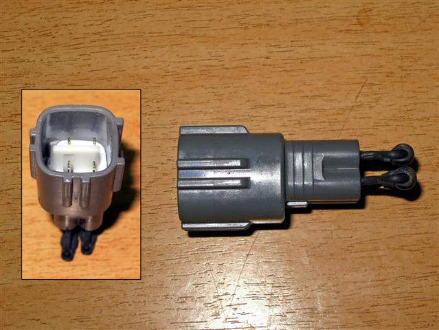

Unless you use a performance ECU or use a 02 sensor eliminator plug (will trick your ECU into delivering full fuel richness), then i'm sorry to say adding a bigger snorkel will only add more air to your AFR (air fuel ratio) which will make your bike run lean!! Lean = same or less power.
02 sensor eliminator (02 simulator plug) below. PLUS as a bonus with the plug you don't need to get a 02 sensor bung welded to an imported exhaust.
