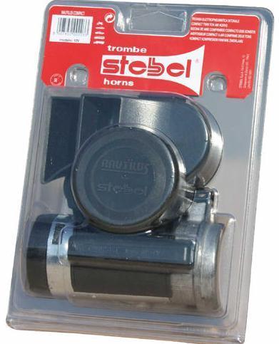

    The dinky little horns factory-fitted to most big bikes are little more than a liability. When trouble looms, you want a seriously loud noise to get the offender's attention FAST! I stumbled across a reference to Stebel's motorcycle air horns whilst looking for a new helmet on Ebay. There are many online sellers, I got mine from Motohorns ([email [email protected]][email protected][/email]).
    stebel-air-horn.
    The Stebel Nautilus air horn draws more power than the factory unit fitted to your bike, but still needs to be connected to the existing wiring / horn button on the bike. Preventing any electrical issues arising requires a voltage regulator and fuse to be installed. The cheapest / fastest way to achieve all this is to buy the horn complete with an "Easy to install Plug'n'Play wiring Kit Included."

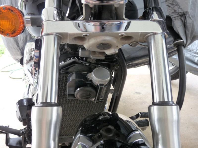

    The unit bolted to the original horn's factory bracket, and is now tucked neatly away.... The bracket really requires a little "twist' to ensure the horn never quite touches the radiator's protective grille, and I'll get that done before long.

    Tony, have you tried it in close proximity to any particularly noisy, obnoxious, local dogs?
    Can you give us a photo or schematic of the way you have mounted it.
