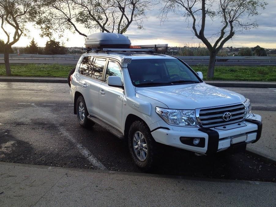

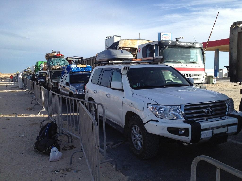

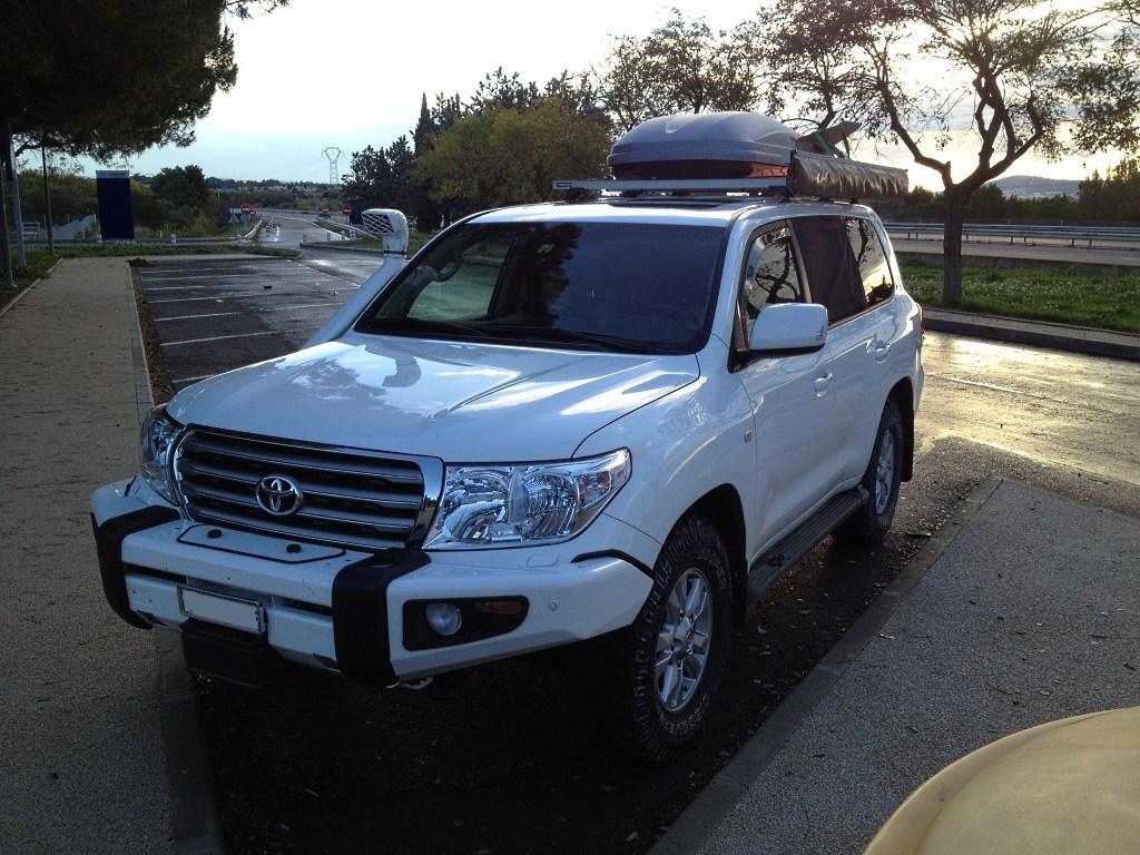

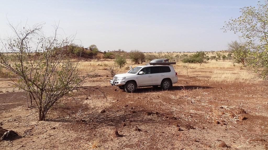

    And here is the car - i had choosen - not just for the transafrica - we plan too to do some other extended trips with this car...
    It is an land cruiser 200 with european specs - hydraulic suspension with allows to lift and lower the car, to adjust the dampers.
    Here the short specs: AHC (Active Hight Control), Adaptive Variable Suspension (AVS), Crawl, JBL 14-speaker system, Iphone Integration, USB Connection, Hard Disk Drive (HDD) Navigation, Anti-theft system, Sunroof, 14 Airbags, Pre Crash Safety System, Four-zone automatic air-conditioning, Pollen filter / Clean air filter, Active Traction control (A-TRC).
    Why such a modern car? Why not? In my experience in laos the locals drive often the never cars than the guys who do the world trips.. Worst case you have to move to the next big capital..
    He is equipped now with an additional fuel tank, a winch, difflocks, 33" mud terrain tyres, sand ladders, ground anchor, a well sorted recovery kit, airbag lift, sideawning and an roof rack & thule roof box.
    IMG_1288.
    IMG_1297.

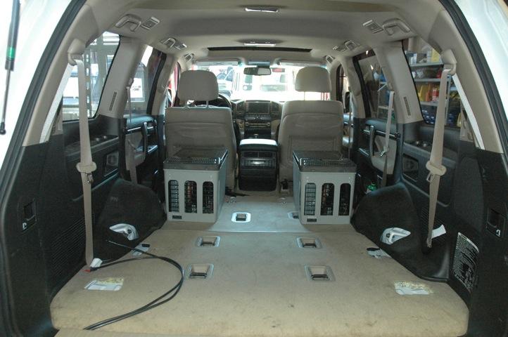

    The plan to sleep inside - need all the space the Land Cruiser 200 have.
    Here is the car stripped out:
    LC-leer.
    Here Fridge and Freezer gets placed (Engel 15L)..
    innen1.

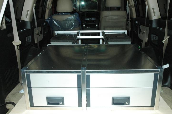

    And some lightweight drawers
    innen2.

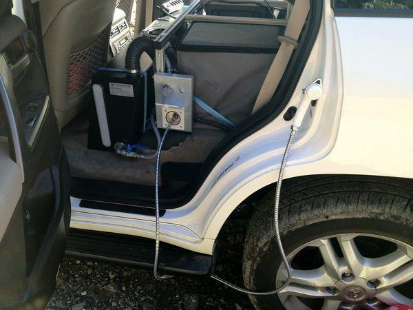

    A Watertank with 85l also
    innen7.
    Water Plug with hot and cold water (heat exchanger in the engine bay)
    WasserTankuArmaturen.
    And here some pictures from our first and only testing night:
    IMG_1212.
    Shower installation
    Dusche.

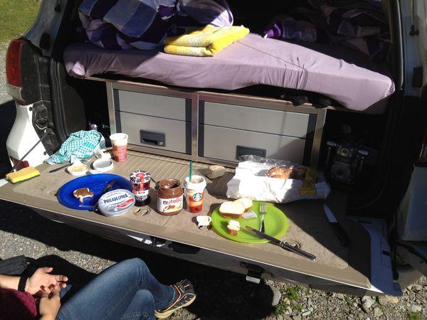

    The Bed and the Drawer System
    IMG_1210.
    There are included so many details, that i can't list all here with pictures. The car comes two cranking batteries - and we add a 3rd battery in the rear, because to run a fridge and a freezer - need some power...
    I had done much research what mattress would be the best - and ended with a swiss product which is used by yacht (boat) manufactures worldwide - Fanello inside:
    It allows to sleep like at home, has mattress and bed rust included in one product.

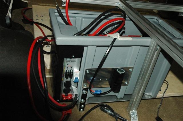

    3rd Battery Setup - National Luna PPP:
    We dont think that this is overkill. To run a fridge and an freezer in an hot environment - need some power. And the V8 Diesel comes with 2 Batterys in Stock configuration - i dont want to use them for our stuff...
    innen6.

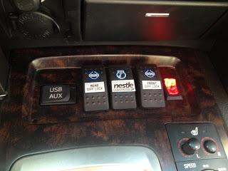

    Difflock`s and Winch Power Switch:
    202523_342720902473283_531299382_o.

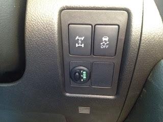

    Additional Fueltank Display and Pump Switch:
    473652_342678192477554_806473005_o.

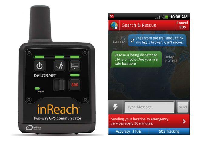

    And we thought about a Satellite-Phone, bacon or something similar.
    After some research i decide me for an satellite Two-Way Messager - which allows you to send and receive short messages over the satellite network.
    There are two products, Spot Connect and Delorme Inreach, who both offer nearly the same - basic functionality - and much more if you connect with your Smartphone (Bluetooth). We decide us for the Delorme InReach.
    delorme-inreach.

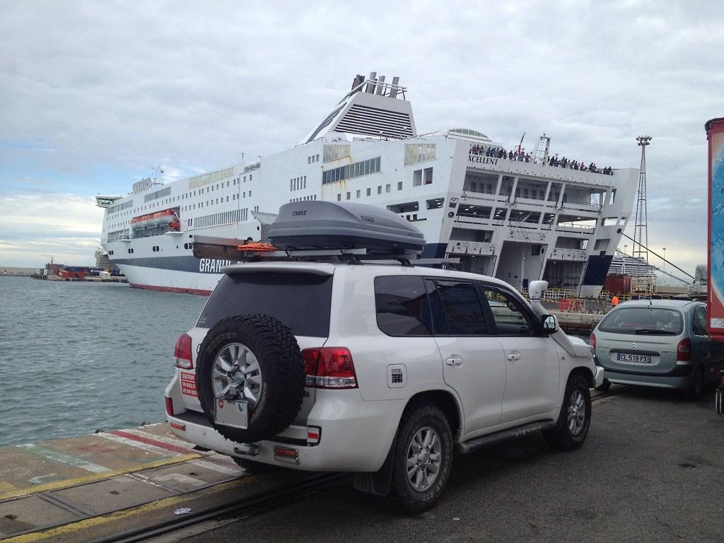

    Day 2
    At 5:30am we stand up again, because we have to be in Barcelona at the early afternoon - and have no idea where the port is.
    Shure we was very early - and found the right port without problems.
    At 12:30 we already was checked in - and had to wait for the entry process.
    The departure was on time. But the ferry itself - we are glad that we dont take the ferry from Italy - and have to spend 2 nights..
    We had a double cabin with sea view - just ok - not more..

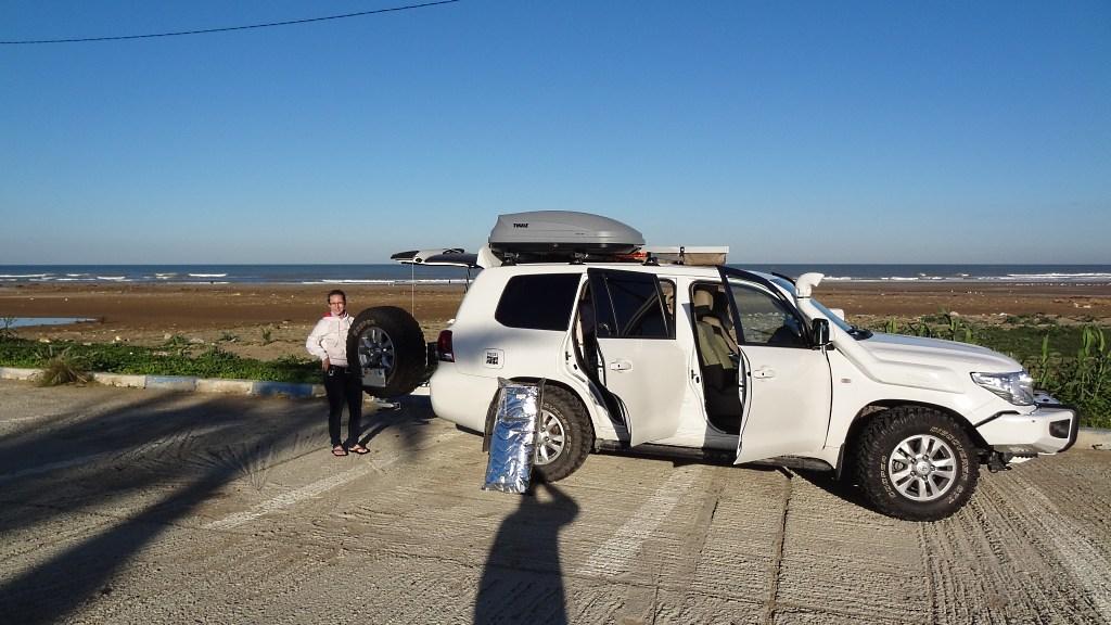

    Because all says - dont drive at it is dark in africa - we looked for a place to stay, during driving - and after 100 kilometers we saw a parked camping mobile on a car park.
    It was a kind of campsite, no toilet, no shower, just a place to stay - directly on the beach - with an guard who wants a small fine.
    Perfect for the first night - we have everything we need - with us :D
    IMG_3335.
    IMG_1313.

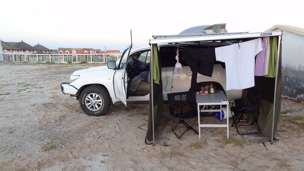

    We built all the equipment for the first time - the awning with sides and cooked us steaks with mashed potatoes on the Coleman, our gasoline stove and treated ourselves to one of the rare bottles of Rioja wine.

    Our Beachcamp-Site
    DSC01488.

    We filter the water when filling the tank - with a three-stage filter system (a coarse filter, activated carbon and a UV Spot) - so we could win drinking water out of a lake or river.
    Inside of the water tank provides a silver mesh - that the water is conserved. We don`t want to know what the restaurants and bars do - for get clean water for ice....
    A long line of cars on the border
    IMG_1337.

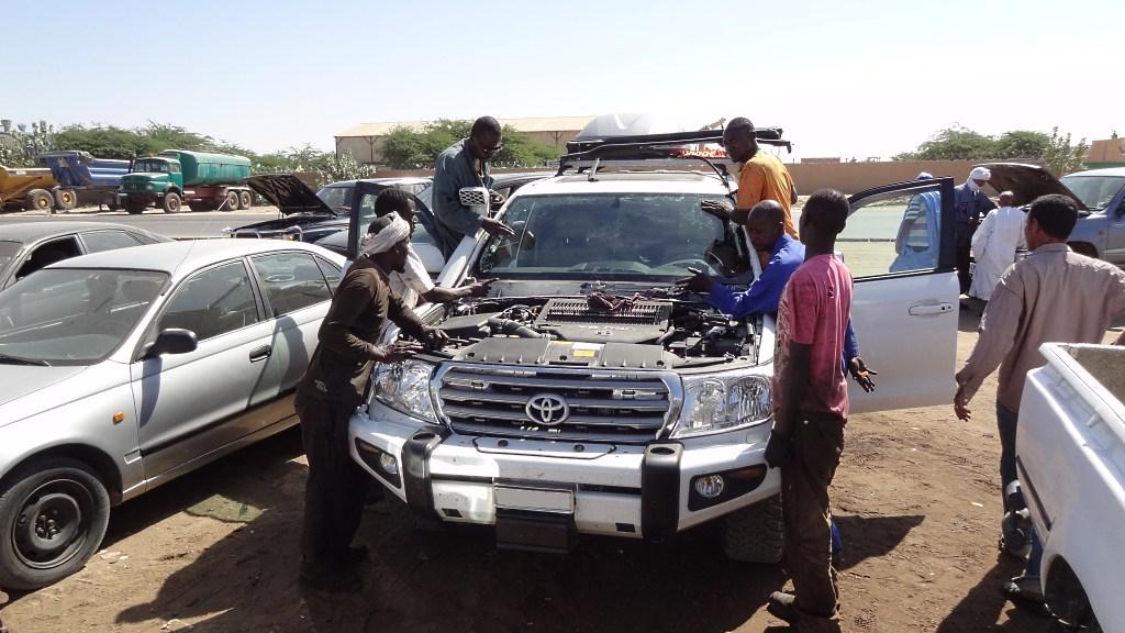

    After a hearty breakfast we drove first to Toyota. Yes - the Toyota workshop was already open - they work too at sunday..
    Unfortunately, there was no good news. A new windshield would not arrive before 60 days by boat and by plane 45 days.
    And they told us - that they only would use original Toyota stuff, and not from the "Market".
    I persisted immediately, and the guy from the reception said that these were cheap windshield "copy`s" from Taiwan available in the town. But they dont will fit not original stuff.
    Not an easy decision..We know that we could possible end with a fully crashed and splattered windshield - when we don't do something. I would prefer a origin spare - but - better a copy than nothing.
    Unfortunately it isn't easy to find an "market" when you don't know - what you search exactly. And we can`t talk to the locals, because of our missing french language skill.
    So I proposed to address the nearest Toyota driver.. I drove slowly beside a Land Cruiser parked on the roadside, in which a man and a woman sat, and ran down my window.
    It took a little bit to the driver ran down the window, we were eyed suspiciously at first. It needs some time to show him - that we want a new windscreen - but not want to go to the toyota workshop.
    He pointed us back - in the direction of the toyota workshop.
    Then we investigated one of these small workshops on the road and asked for a new windscreen. Several people helps to translate - and at the end we had an offer for replacing the windscreen inside of 3 hours.
    After about 4 hours, where I oversaw the dismantling of each screw - we were ready to start again.
    For shure - the windscreen copy just fits inside of the Land Cruiser 200.. But there are some cables who aren't used in the african version of this car. There are rain sensors, and some cables for the front heating who hasn't a part to plug in. Anyway - we got too the rainsensors to work ;-)

    6 guys worked on our car
    DSC01613.

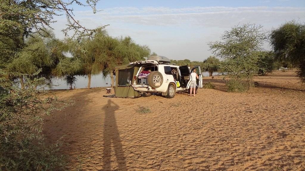

    Our camp
    DSC01723.
