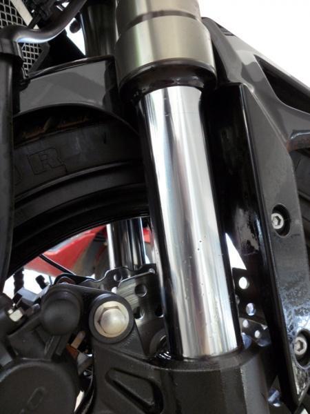

Just wondering, has any one else had problems with the fork oil seal, as mine sh-t its self yesterday, and covered my brakes in oil with only 10k on the clock??

A leaking fork seal after only 10K km - I'd say either faulty part or sloppy installation. You have to slide them on very carefully, it's easy to damage them if you're not doing it exactly right. Probably a sloppy job during assembly. No dents, scratches or rust on the leg?
Don't think it has anything to do with how you ride roads or tracks. Seals should last way longer than that under any condition.
And if it happened only on one leg that proves my point.

Yes, it was a faulty seal obviously from manufacture.

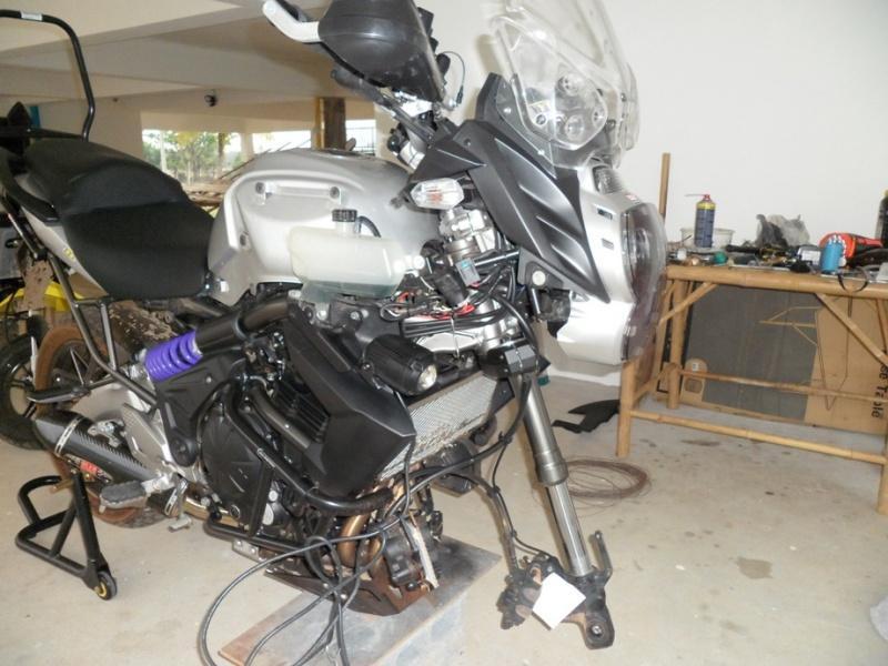

Could not be arsed with the warranty as this would mean riding to Korat and then pulling my hair out while i watched 2 inept mechanics trying to repair it, so did it my self and replaced it with a hydraulic ram seal i found in Mukdahan topped up the oil level, all in less than 3 hours including finding a seal which was the hardest. Decided to change the bike this year, because i am doing to many off road km and the bike was never really designed for this.
