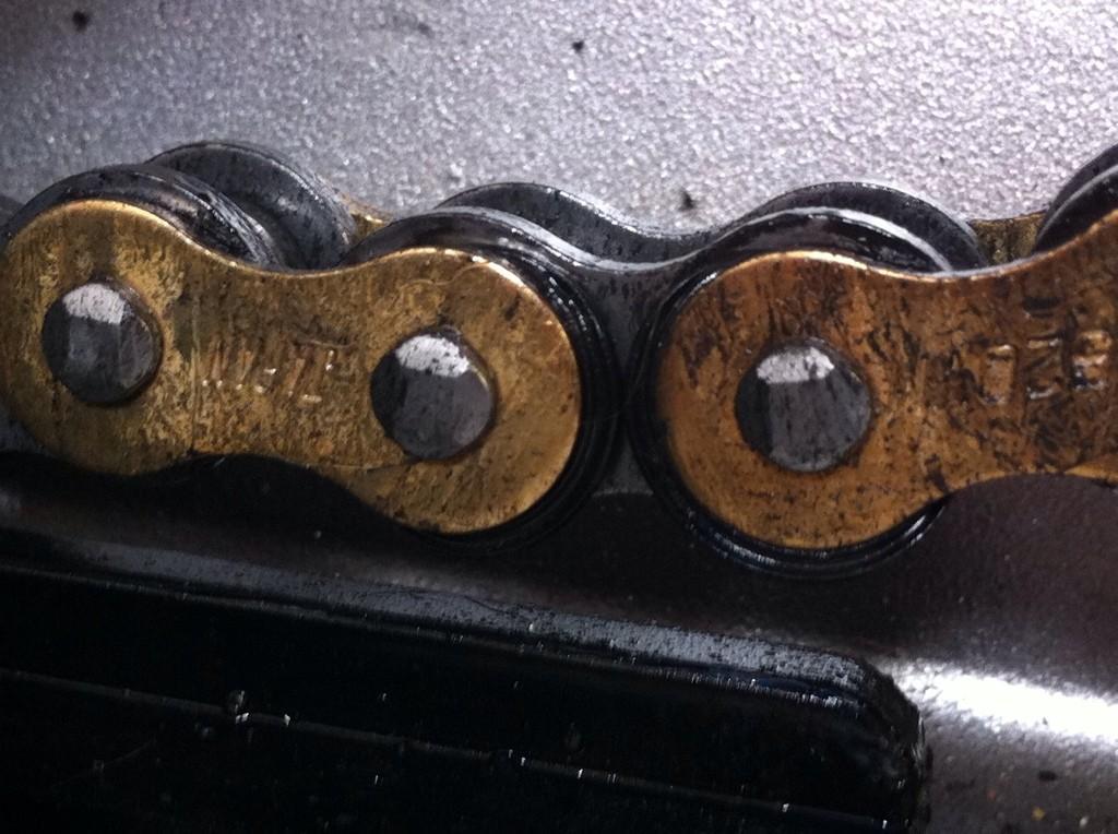

just looking at that nasty deformed Hooked chain in the photo , any one can see that sprocket and any chain running on it is totally knackered scrap and dangerous ......Kawasaki doctor is a Moron ,

At first I thought: 22K should not wear out a chain. I had several used bikes with 22K miles and the chains were alright. But maybe the dirt in Thailand makes things wear out much faster, or the parts are low quality. Or you didn't take care of the chain after a wet ride. What kind of lubricant do you use?
Every Honda Wave manual shows when to replace a worn chain. If you look at the photo, yes, it is definitely time! The tooth in the bottom of the pic is almost gone!

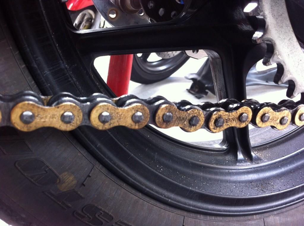

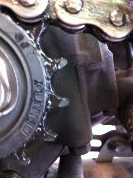

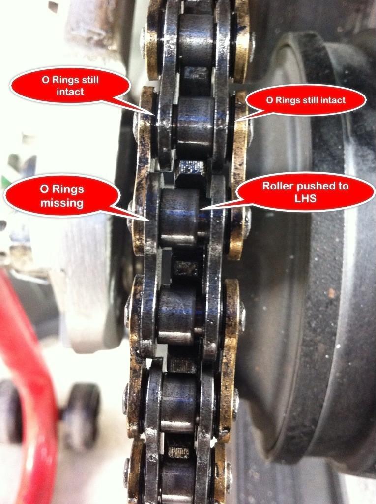

Oct 30, 2010
203
Any of you versys riders experienced a random loss of drive chain O rings specifically on the LHS of the chain like pic below?

Thanks David but actually I believe my issue goes beyond the chain. The pics that I have posted are from a new 2012 versys that has 10,000km on the odo and have 3 chains chains ( 1 oem chain and 2 DID X ring chains) destroyed.
So as not to hijack the OP's thread, the subject can be found here ... http://www.kawasakiversys.com/forums/showthread.php?t=20460

You are not alone with the o rings pushing out of your Thai chain it happens to them all I could not believe it when it happened on my bike as I have never seen that before.

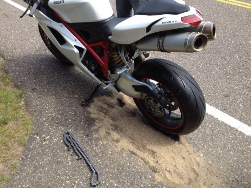

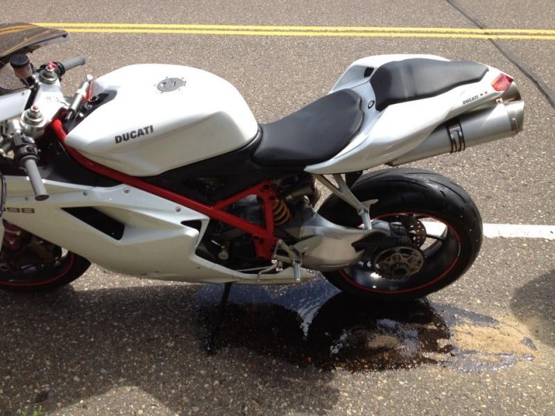

Mar 1, 2012
On the subject of DID chains. The following pics are from a friends group ride last weekend in the US. The caption with it was "Will never buy another DID chain"
