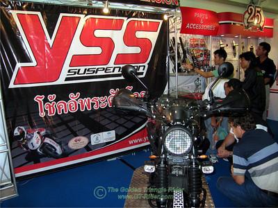

I have been fortunate that YSS Thailand used their skills on adapting a shock setup for the Scrambler using my bike as a guinea-pig.
![221816947-L.jpg%20](http://RhodieBKK.smugmug.com/photos/221816947-L.jpg%20)

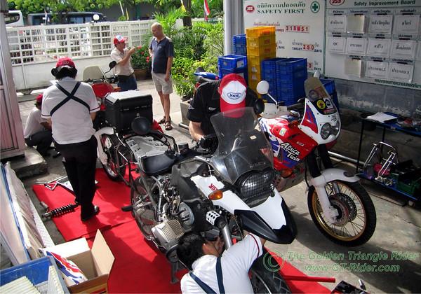

They do make shocks for other big bikes.
Africa Twins & BMW R100GS are two that member have asked about.
