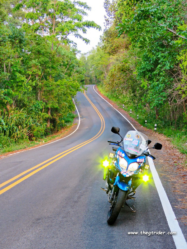

I now run the Baja Design through the high beam switch & the yellow Loboo lights through a manual switch as running lights.
BUT
I have been enjoying night riding so much, that I have picked up another set of discounted Loboo white spotlights to add that will run through the high beam switch. These will all be fitted to the 2017 model I just bought, giving a total of 164 W LED on high beam. Stay tuned to see how it goes.
