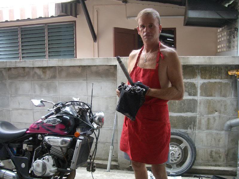

After 2 previous visits to Chiang Mai, renting motor bikes was looking forward to this trip with my own bike, (even if it is pink, and I bought it up on my trailer..). Since having the head bearings replaced, on the bike, a while ago, have always had trouble with the head bearings working loose, so this time before leaving Phuket, I removed the triple clamp, cleaned it up thoroughly, and used a liberally amount of ‘Loctite’ on the thread, hoping this will cure the problem..
By the time we had triailered the bike, about 1,500 miles to Chiang Mai, (via Isan), the head bearings had worked loose again. So whilst in Cnx, rode to see Snail, and ask his advice. When we stripped the forks down again, noticed that the balls had started to disintegrate, and there were small metal filings all over the place. So a new set of Genuine Honda Balls were installed, and we hoped this would solve the problem. (Seems the mechanic I had previously been too had used aftermarket balls).
Now.... where does this bit go......

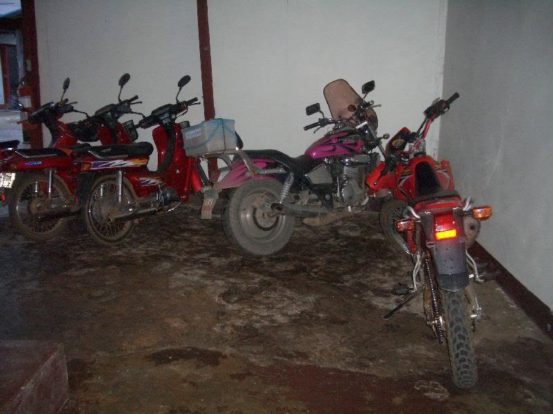

And Miss Pinky can be parked under cover

So when finally getting back to Cnx, called into Joe’s and we had another go at tightening my head bearings up again, this time we replaced the cups as well, and so far seems to have done the trick.

Not only is the red apron suspect but what indeed is he gonna do with that lubed up steering stem???

Pikey, my balls great now, no slop at all.......
